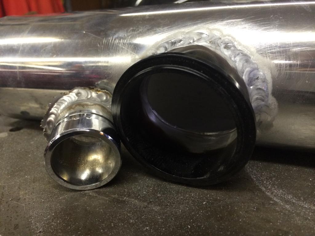

I determined that the blowoff valve that I had was too small (1.25" pipe) so I upgraded and got a 50mm one from EMUSA. It was a bummer cutting off the nice welds a friend did on the old one, but I was able to get some practice on tig for myself.

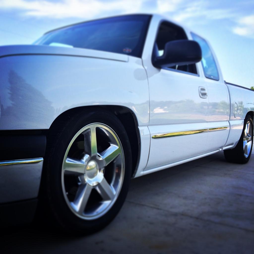

I ordered GMC trim on ebay. It's stainless steel and really nice actually. Fully covered with 3M on the back.

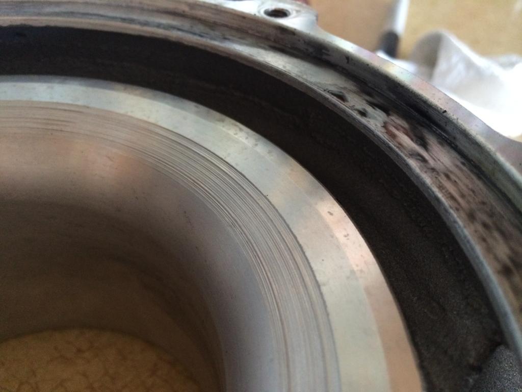

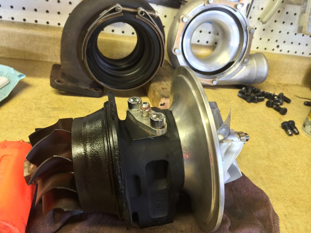

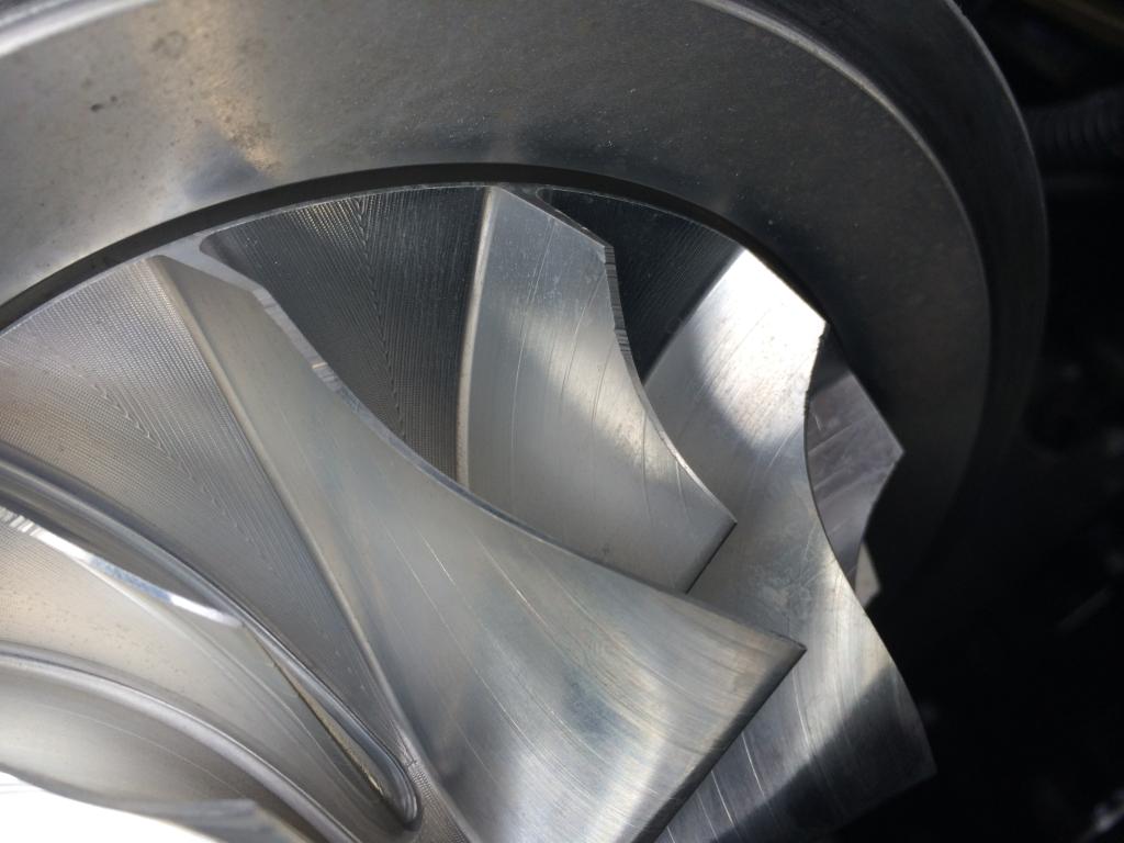

The spring in the new blow off valve was super stiff and I didn't realize it for a week. So it wasn't opening at all. That, combined with the old one being too small (even though it worked) I think ruined my turbo. Not to mention the couple hot shutdowns I had to do when I lost belts and broke the harmonic balancer. So the thrust bearing was shot. I started looking into it when I was getting a lot of smoke out of the exhaust at idle. Like a constant stream.
There was .013" of play which caused the wheel to rub on the housing.
I called Precision and the only helpful thing he had to say was that the cost of a rebuild will not cost more than a brand new turbo ($1700). I was not about to put another grand into this one since they are the only company that can touch it. I looked into 3rd party rebuilders but they are not able to get parts. So I said screw it, now I have a nice paperweight for now and just ordered a good Borg Warner S480 from forcedinductions.com
I'm currently waiting on the S480 to come so I can start driving the truck again. It's been down for a few weeks now. New turbo is a T4 1.25A/R exhaust housing and race cover. I'm looking forward to it. As for the Precision, I'll hang onto it for a little bit and eventually send it in for a rebuild and see what they say for the cost. Hopefully it's cheap enough that I can sell it and make some money back once it's fixed.
