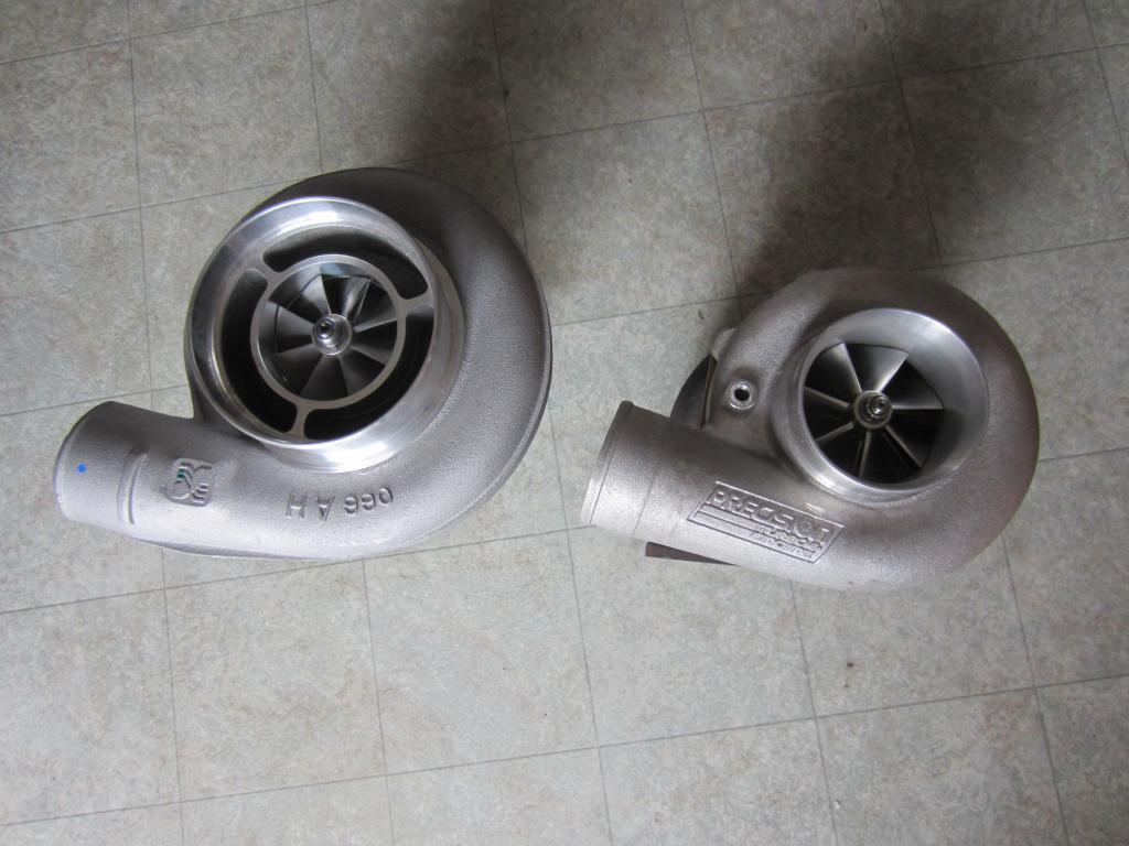

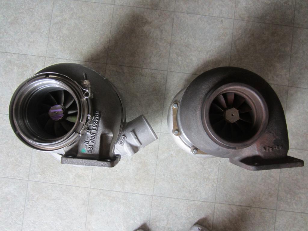

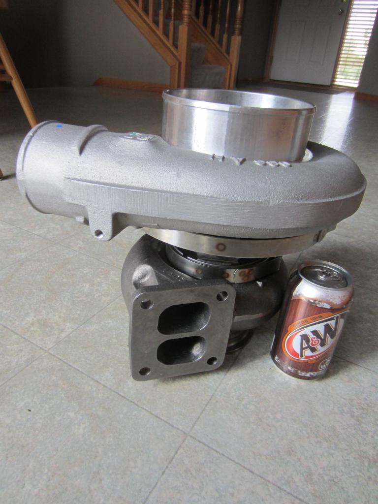

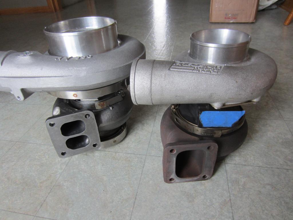

Here's the new turbo. It's turning into a lot more work to get it installed than I was planning. I was thinking/hoping I would only need to modify the downpipe a little, but I have to relocate the coolant tank, reroute some coolant lines and then do some downpipe work.
Some comparison shots.

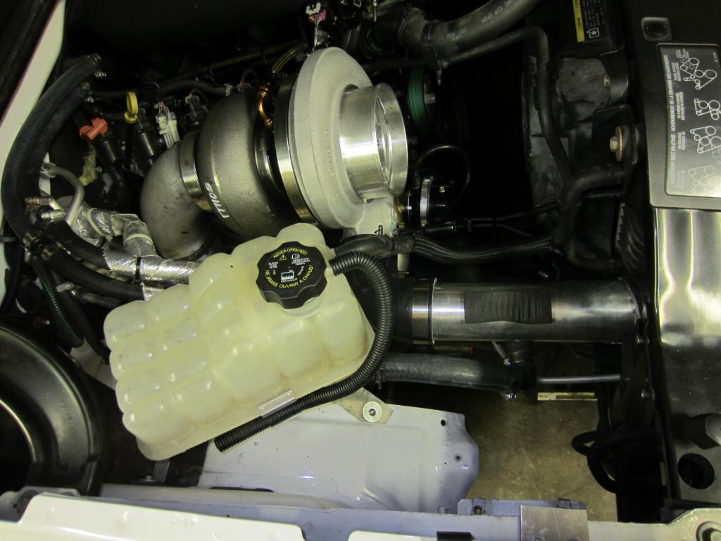

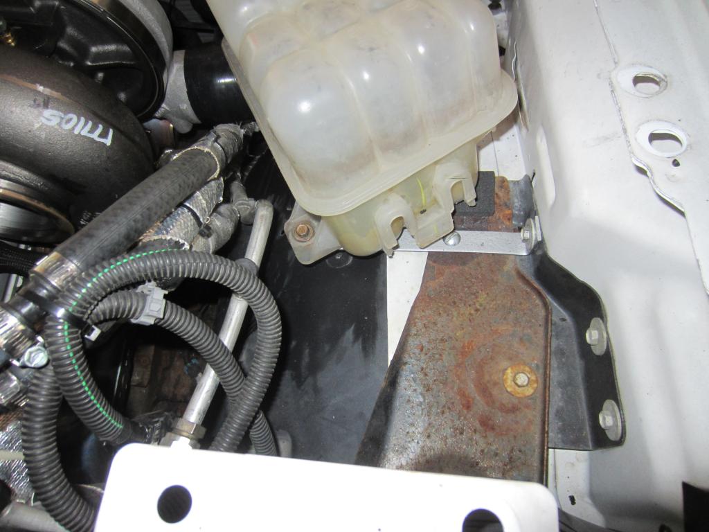

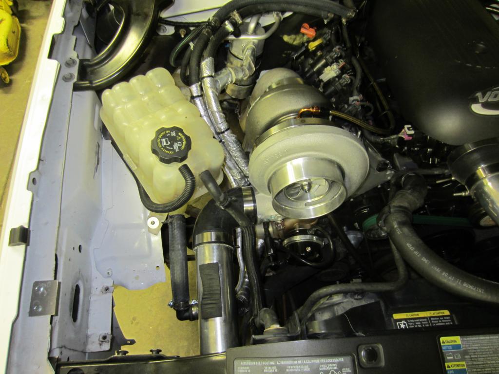

How I ended up rotating the tank. I heated and cut some parts off the front mounting leg and made it sit right here on the fender. That upper hose I was able to just rotate and not cut it or anything. The lower hose I moved and have to throw a 90* on it and extend. It's at this weird angle so it can sit in far enough and low enough to clear part of the hood that drops down.
Then just made this little bracket in the rear.

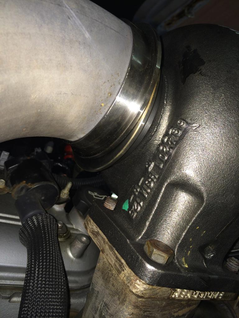

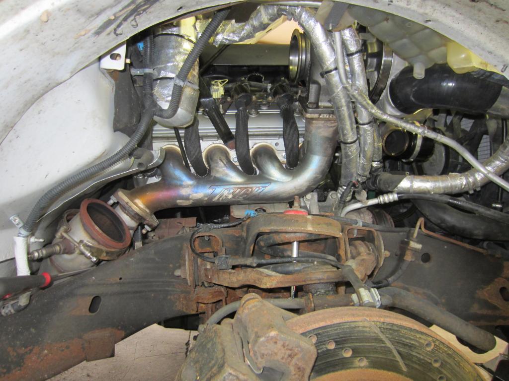

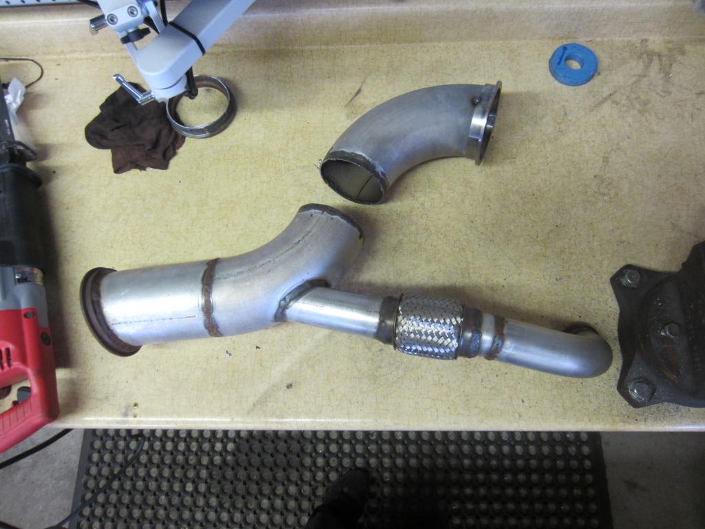

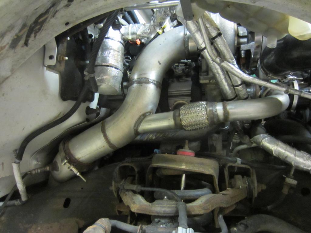

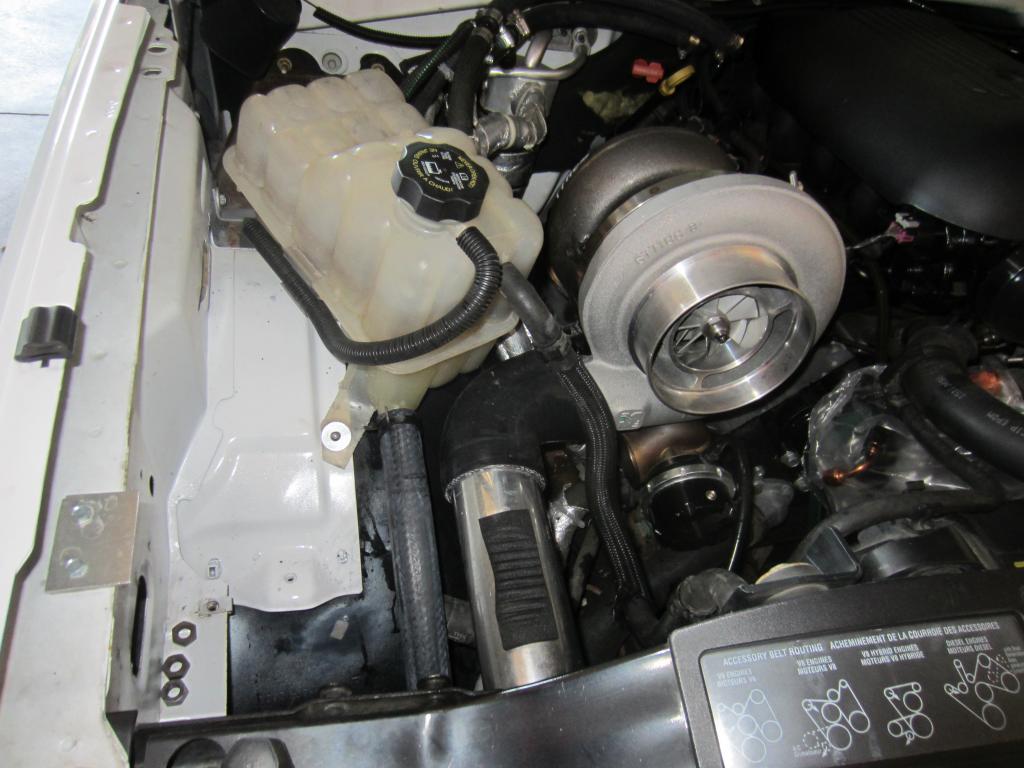

Got it done today! The downpipe actually went a little easier than I was thinking. Only had to cut it twice. My first cut where I removed the old V band flange for the turbo was perfect on the first try. I didn't even measure, just knew I had to get rid of the old flange and that ended up setting my forward/back length perfectly. Then I just had to adjust the height. The BW sits a little bit lower. All I am waiting on now is a 5.5" to 4" reducer elbow for my air filter. Only one I can find is around $70 though. Still the cheapest option though vs getting a new air filter, clamps and elbow.
I took it for a 5 mile test drive tonight and so far it seems to compare almost exactly to the PT88. I'll be able to tell more once I get to start beating onit again and borrow HPtuners from my friend again and check it over. I took it a little easy to give the turbo some break in time. The blowoff valve is finally working perfectly.
Back to the same view I saw a lot of last winter.
Height difference.
All back together.

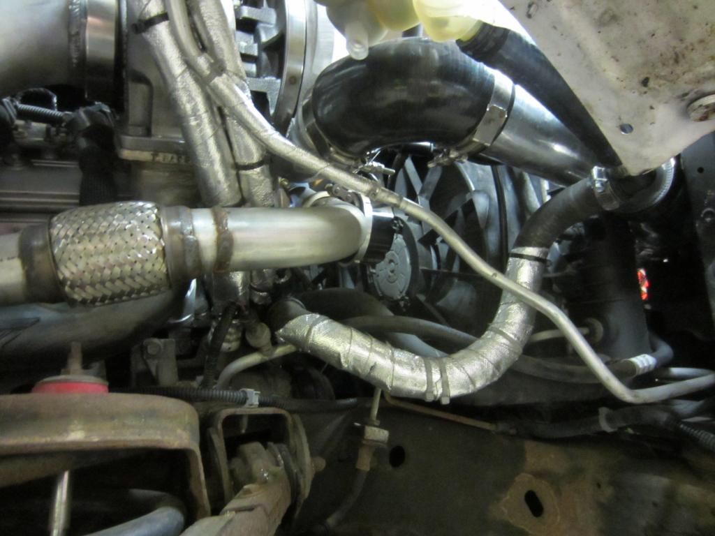

Here's my new coolant setup.
The coolant hose used to go up right under the silicone elbow.

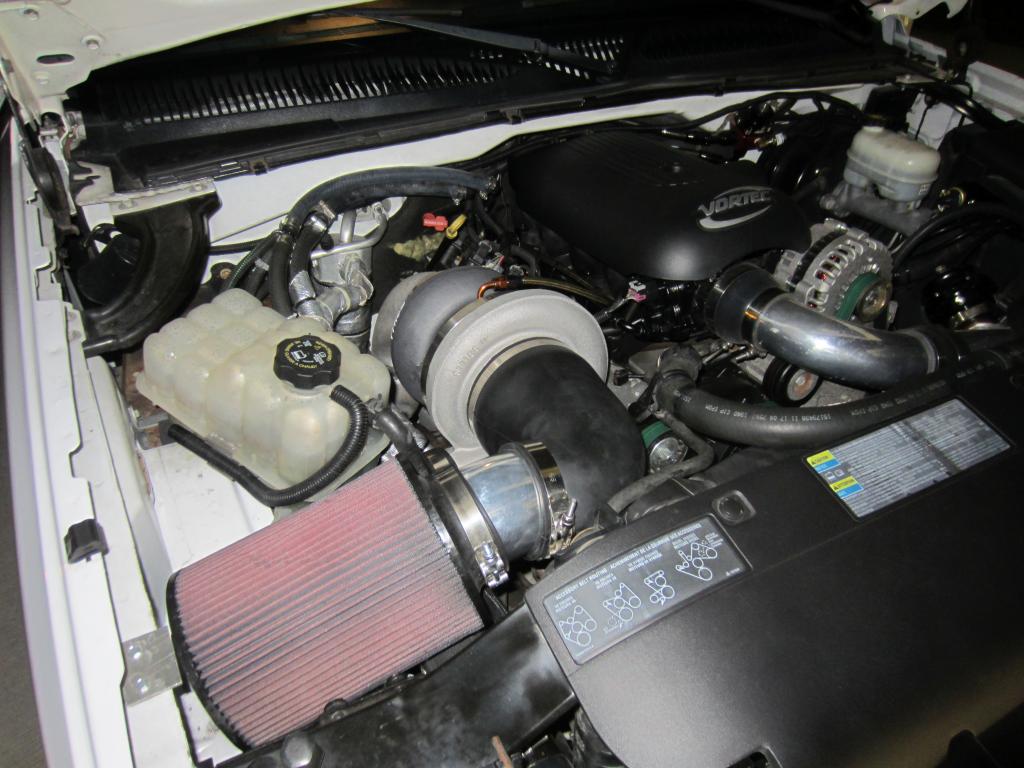

1 week later, I finally have an air filter on it again. Only drove it about 200 miles without, shouldn't have been too bad for it.
Also, check out this 7 second video from 50mph and spinning tires. About 15psi right now.
