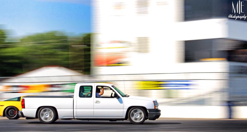

Been busy keeping this thing together. I've been throwing belts and finding other weak points. All minor things though. It mostly held together for powercruise, besides destroyng my balancer on the very first lap on the track. That was fun tracking down a new one and getting it on at the track, not as bad as the engine swap in a Dakota R/T that we did also though! he melted two pistons his first session on the track on the first day, Friday. Had a new on in and running Saturday evening to drive home.
Some misc pics, I have more to post when I get time to sort them out and uploaded.
Holding off a vette

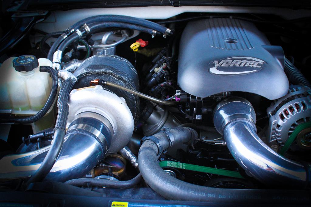

This was unbelieveable. Not prepared for this but we pulled it off. Everything worked out perfect, he knew a guy who was coming up already and he happened to have an engine at the house to bring with him for Mike. Basic hand tools that we brought with and rented a few from O'reilly. Hoist was also rented.
It's a rear mount turbo. Pistons 7&8 looked like this.
