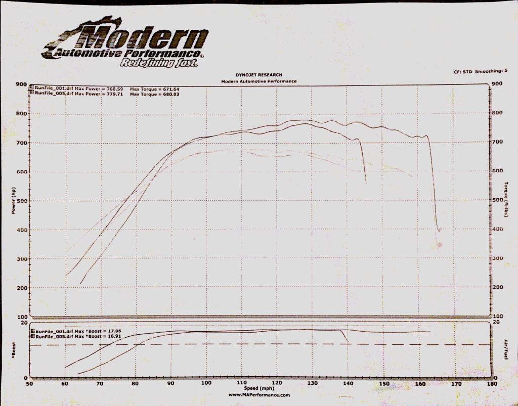

I've got them! And a dyno sheet
Carl tuned it out of Lancer Service in St. Paul. He is "the guy" for boosted LS around here. I got the truck back on Thursday and it's insane. 17psi is a lot for the street! Tires just spin if I'm cruising around 65mph, haven't tried it any higher yet. Goal was 20 psi but with the waste gate springs I gave him, he was only able to get that high with the manual boost controller. Was supposed to be a spring combo for 14psi but 9 was all he got.

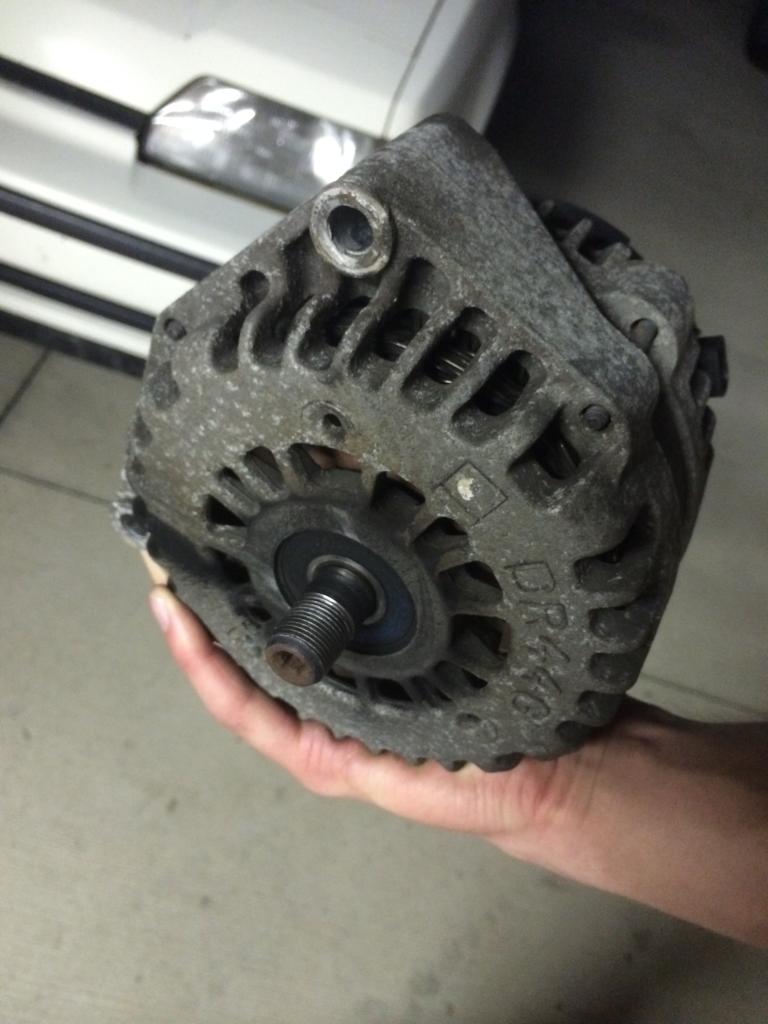

First night I had the truck back on full power and was playing, the alternator pulley wasn't as amused with the new power as I was. The nut loosened up and stripped the shaft. Left my stranded 2 miles from home, so I got a nice walk back to the house to go back and tow it.

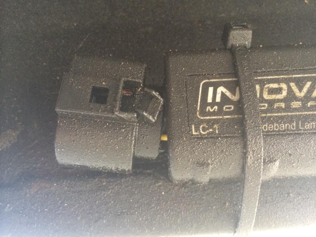

While bouncing under the truck when it came off, it hit my wideband and took that out as well.

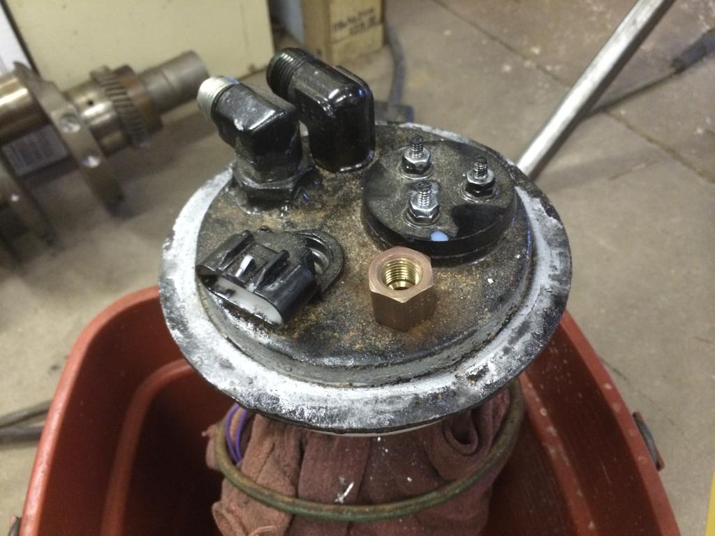

I also finally got my fuel tank venting fixed after 800 miles only filling 5 gallons at a time. Drilled out the top of the pump assembly to install a breather tube that runs up and tees into the filler neck with that other hose.

779hp and 680tq at 17psi. Unlocked converter.

Serious power, I'm loving it. I love how flat that boost curve is. PT88 still getting it done.

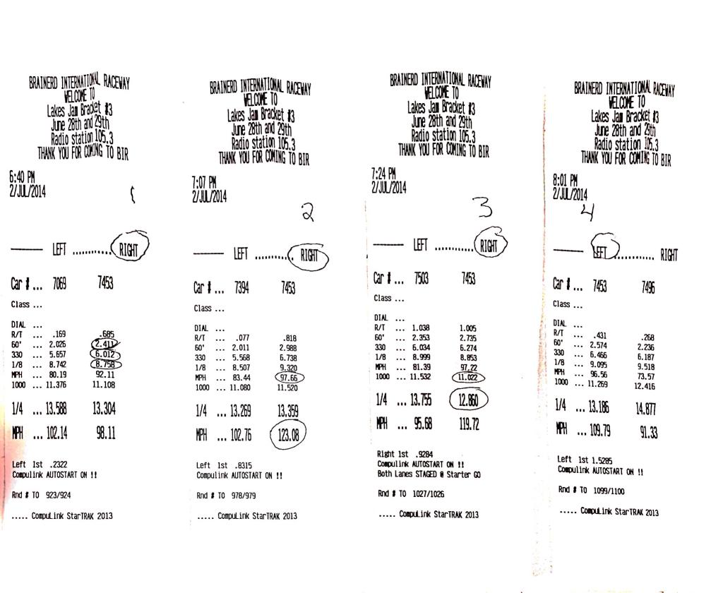

Went to the track yesterday and had a hard time launching with the street tires. It was a lot harder to drive it turbo'd than last year NA. I used to be able to hold the pedal to the floor, but now I had a hard time controller thottle.
Circled my best numbers. Spun halfway through second on every run, slightly less each time though.
