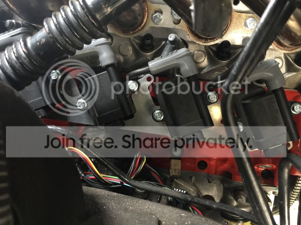

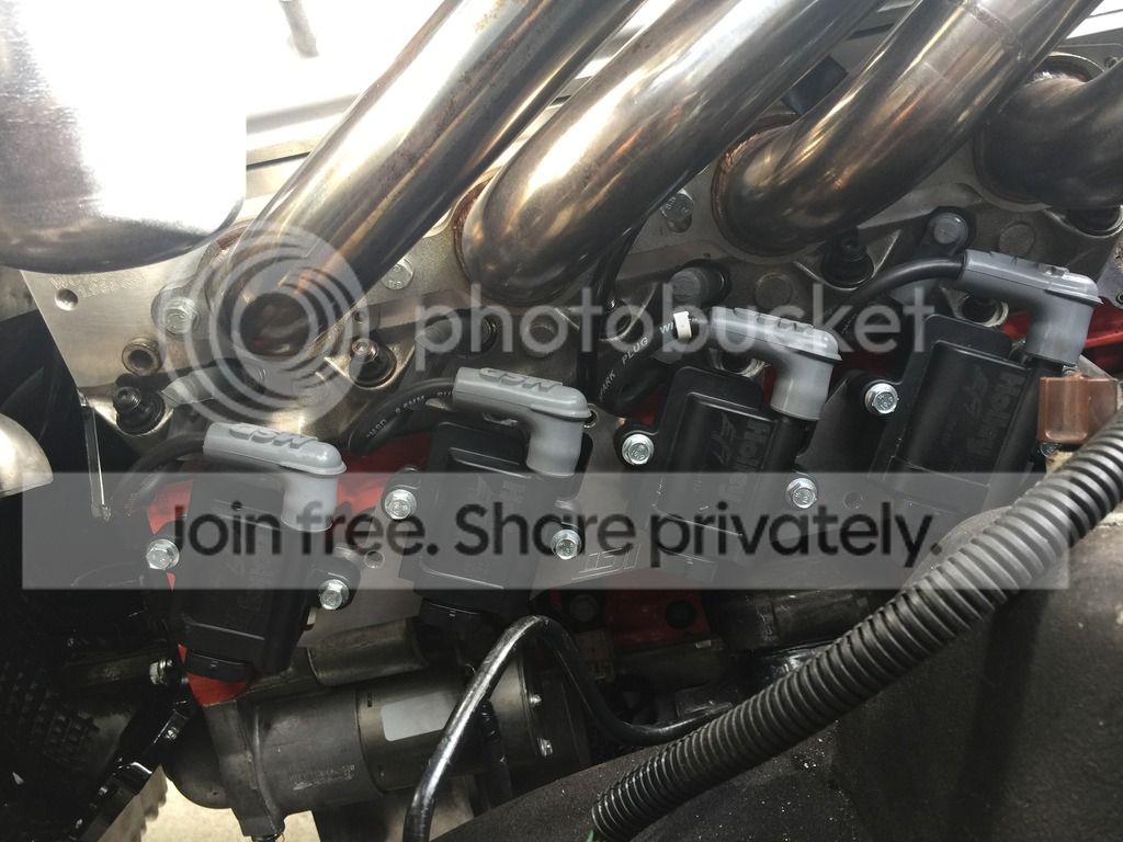

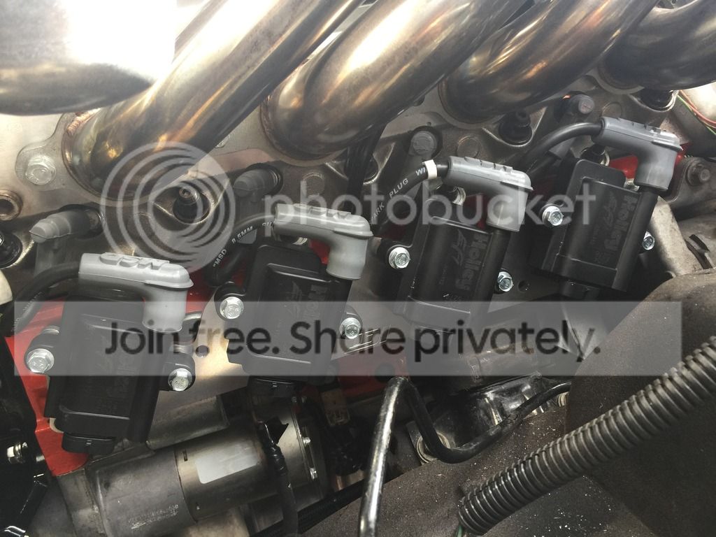

Originally Posted by Three6GMC
Little update...
Finished with the coil mount relocation, got the truck aligned and the exhaust stacks trimmed down. Got the truck inspected already so just need to go get my new registration sticker and truck will be good to go for a street tune. Its still on the stock pump right now but I have everything already to put in the new pumps. Wanted to make sure everything was good to go with the TCM/4l80e swap and the harness rework before I messed with the FPCM....

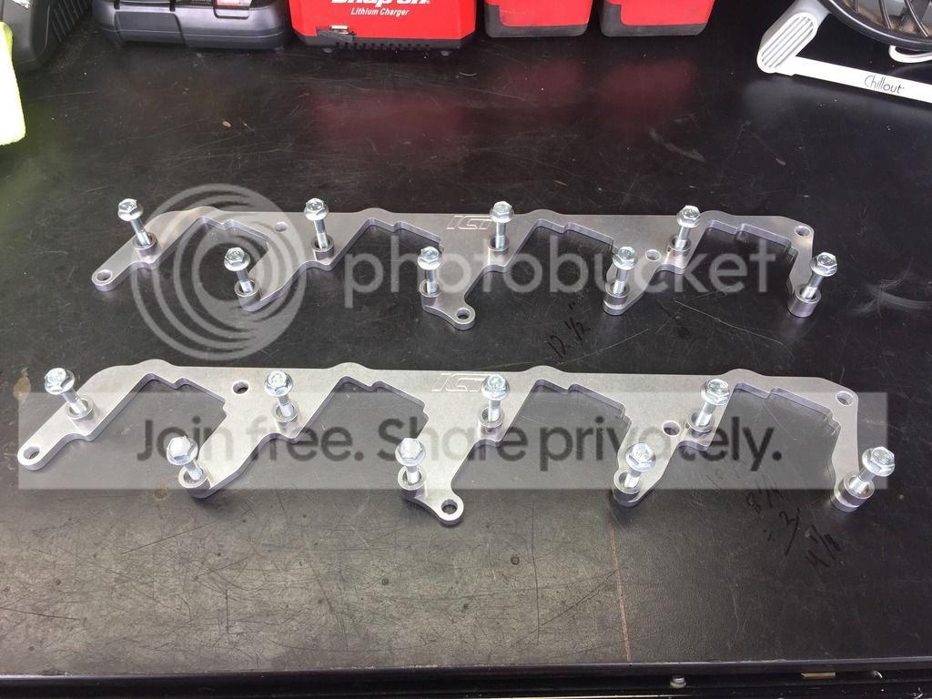

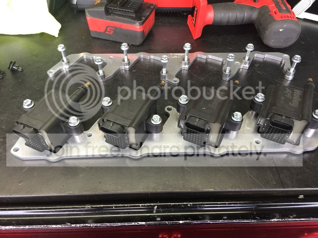

Originally Posted by Dbyers2
Any chance we can get this on a mass produced level I need these lol
They are in mass production lol... They are brackets that are supposed to replace the metal coil mount bracket on Ls valve covers. They happen to fit perfectly down low by mounting them off the back bolt on the ac compressor and off the power steering support bolt on the side of the block. What I used for bolts were those stud type transmission bolts, the one that are a m10 1.50 on one side and like a m6 on the other. That let me replace the stock bolts on both sides of the block and add a stud to mount the coil bracket to. Hopefully that makes sense, if you need better pics I'll get them for you.
https://m.summitracing.com/parts/icb...fLTxoCzW_w_wcB
