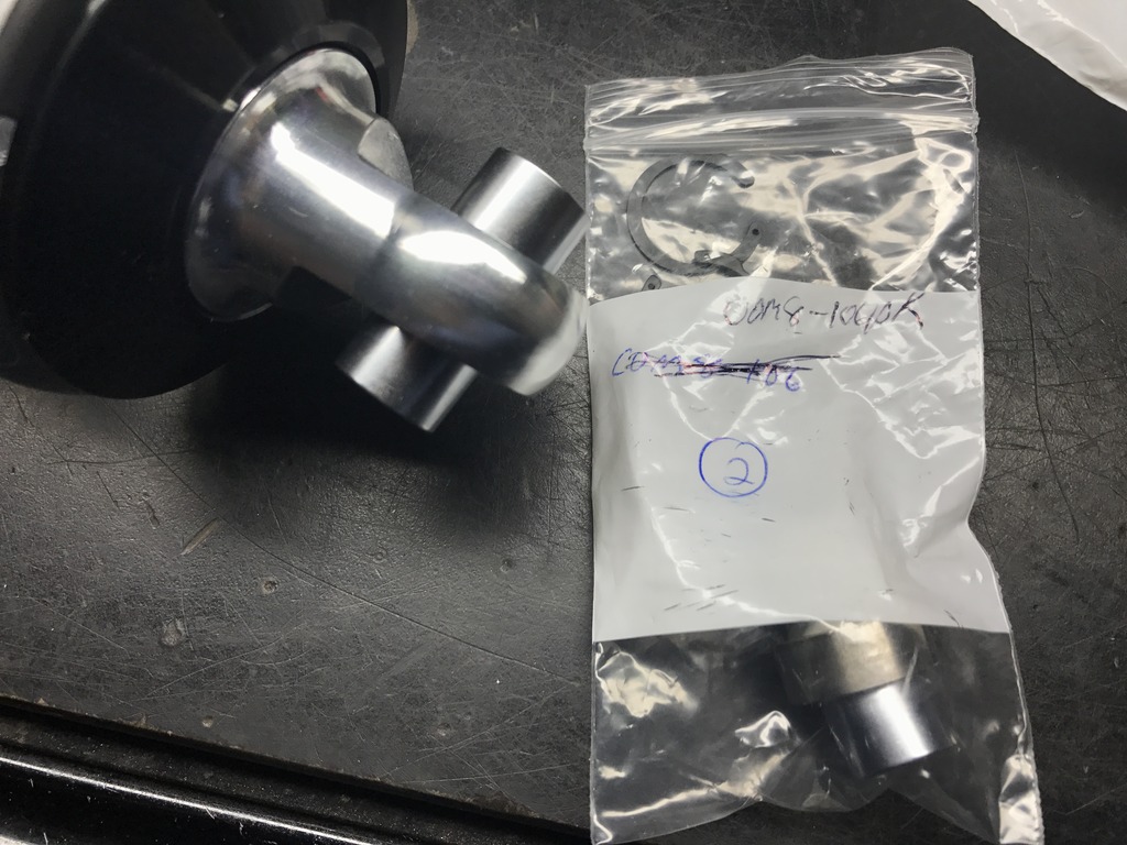

Ok small update for the coilovers, I updated the parts list on the previous post so everything is good and up to date on it. Anyways for the bearing kit for the DS501 shocks to fit Atomics brackets perfect are COM8T-106PK. They are 1.5 inch wide so no need for spacers.
