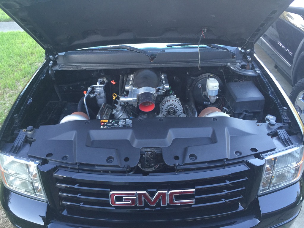

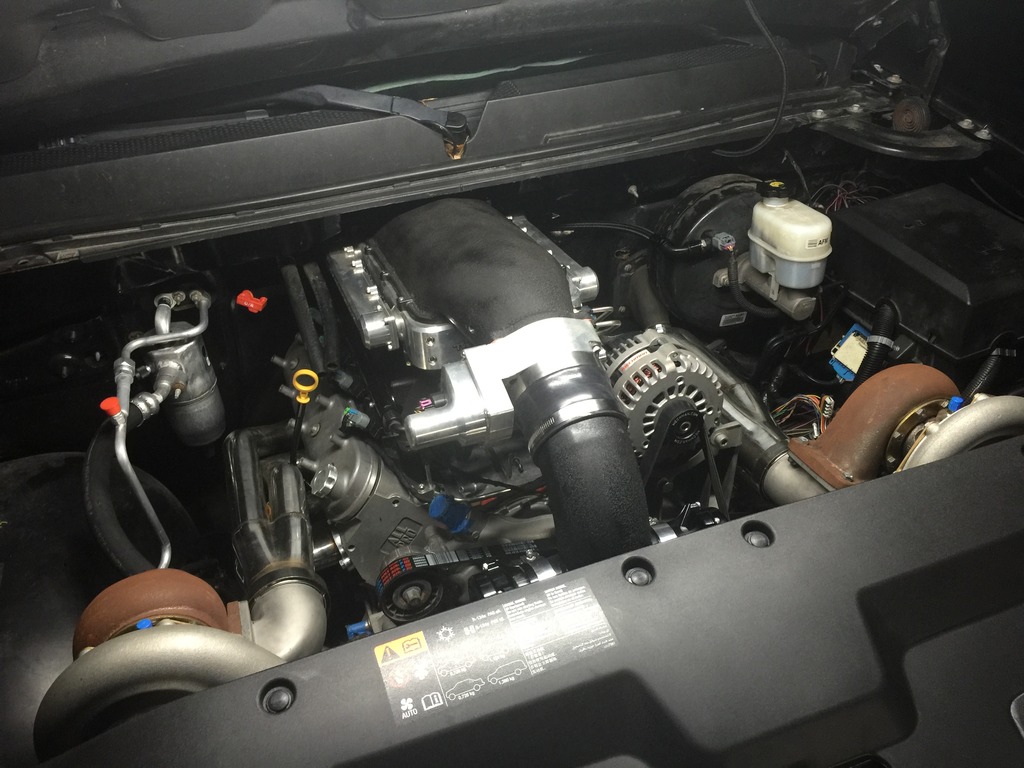

Originally Posted by Atomic
Your setup looks awesome don't get me wrong, but so do the 3000 other twin turbo LS trucks with some effort in them. Never seen one with both turbos on the same side though that's not a diesel...
I hear ya and never know I might go back to that being thats how I originally wanted it. Like you said never really seen too many setups like that which is why I wanted to do it like that in the first place. Will see what happens...

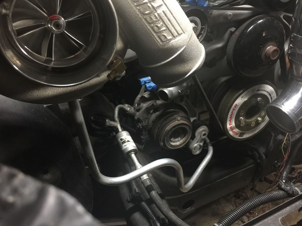

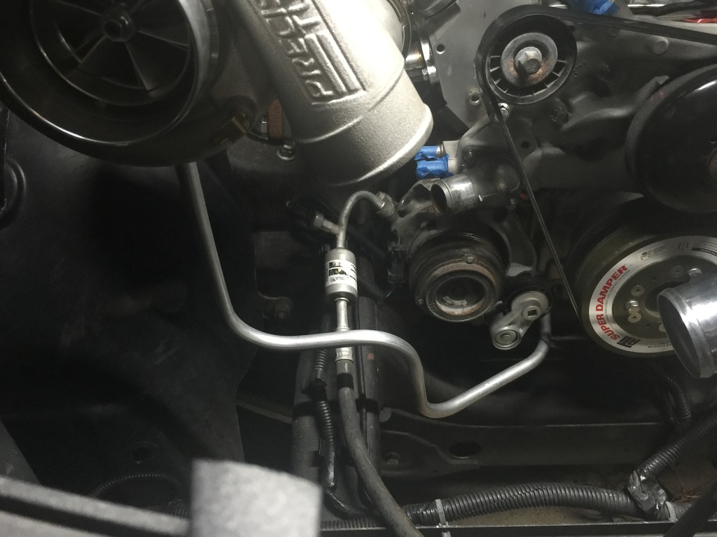

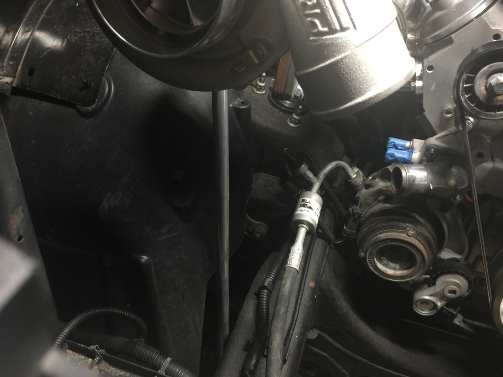

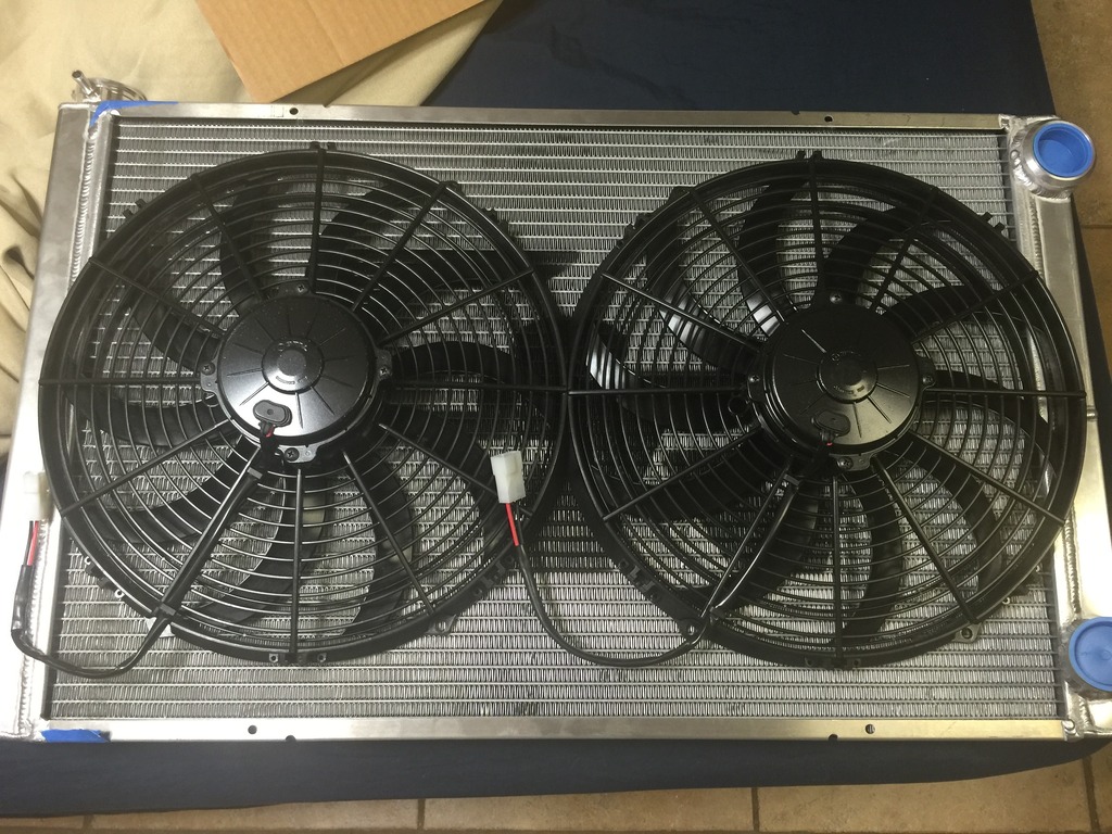

Well been busy with work but did manage to get a few little things done. Got the oil drain done for the passenger side turbo, fixed the issue I had with the shifter not hitting every gear in the 4l80e. That was a simple fix just needed to swap the shift mechanism in the column and was good to go about 45 min later. Got that all buttoned up and one less thing to finish. Also got blow off valves welded to the intake tube, and started working on the lines for that. Fans came in so gotta draw up a template to have the shroud cutout so I can get those mounted and done with. I do have to cut the radiator cap and re weld it off to the side so it fits under the radiator support but thats no biggie. Getting more and more parts in the mail so slowly getting it finished up. Shooting to have it fired off some time this month to make it to a local dyno event next month.
