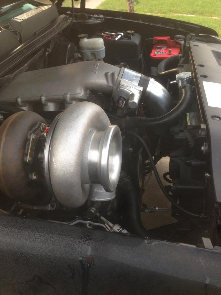

Oh and before I forget I noticed some of the guys running the Hi ram intake try and run the intake piping to it from the bottom and straight up with various couplers. Well Treadstone makes a 70 degree bend that fits perfect with the angle of the intake. Just letting you guys know.
I ordered a 60* vibrant tube yesterday dammit

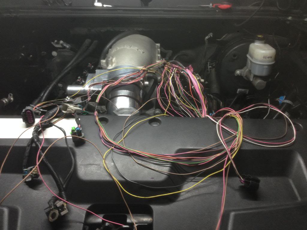

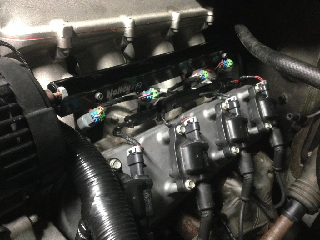

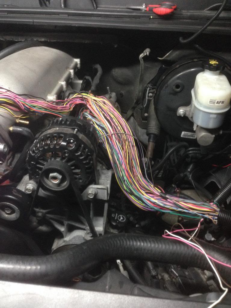

Getting closer and closer!.. actually fired it up earlier so soon will be at the track doing some test runs...
Some progress pics for now till the running video comes. Just cleaned up the wiring harness to fit the intake a little better.

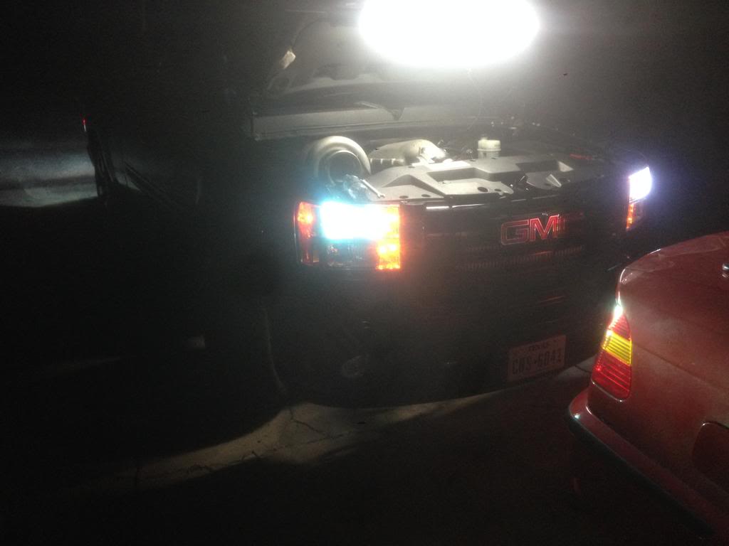

Back on its own power...

Hell Yeah well got the truck done just need some more tuning but its runs and comes into boost VERY agressivly lol. Also I did get the 5 inch downpipe to work with a crossover behind the engine so YES it can be done with a good exhaust shop. I broke my phone earlier so ill have to wait and take pics tomorrow. Need to setup the fuel system and the meth system but so far on just 10lbs this thing lights up the tires and just pulls WAY harder then my nitrous setups and other turbo setups super excited!
