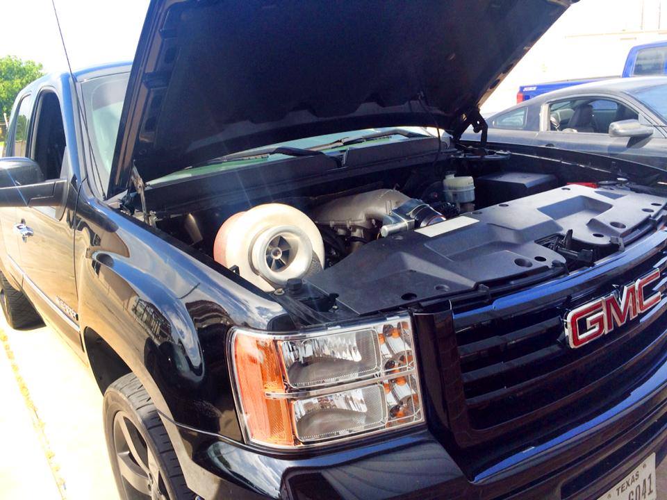

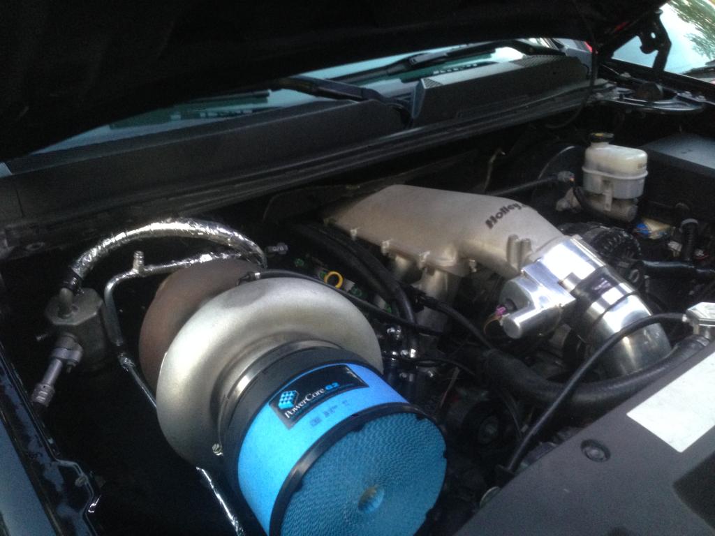

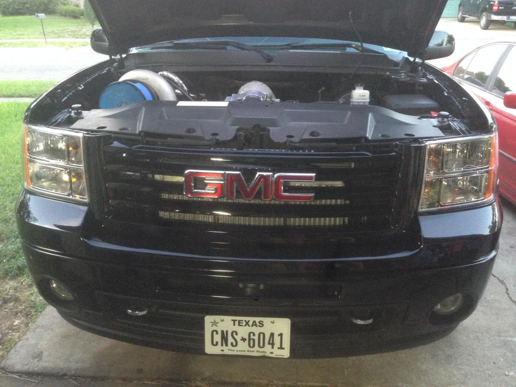

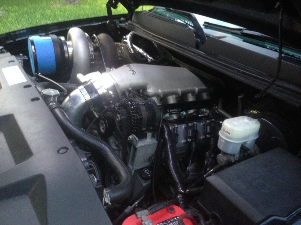

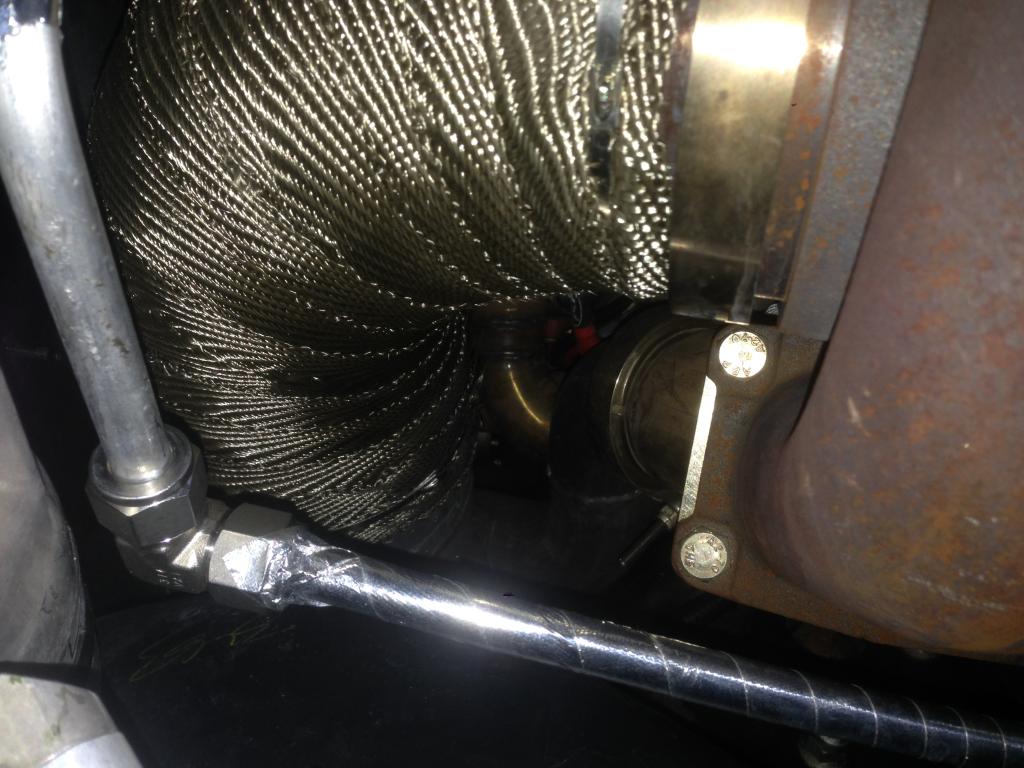

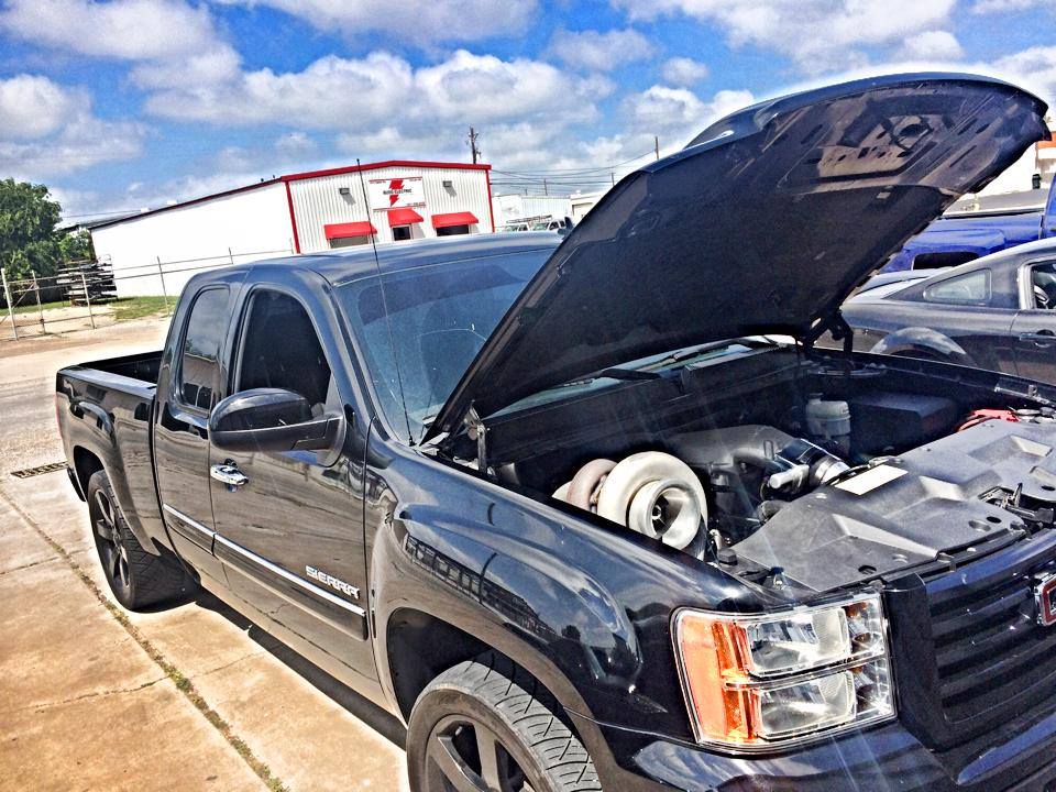

And its somewhat done and driving good! On only 6 lbs right now because I'm still waiting for my fuel system to come in but man this thing even on only 6lbs pulls way better then my 150 shot. Still gonna run nitrous up to a certain boost level to help spool up but honestly for the size this turbo really responsive. Here are some pictures of this never ending project lol. Looks funny with the big Volant power core filter but when i race it comes off and a screen goes in its place. Also like I said in the other post I was able to get the 5 inch downpipe to fit with a rear crossover pipe... Still have a lot of cleaning up to do on it and redo a few things but so far so good.

Still want to see better pics of that downpipe fitment

5" DP AND A/C....an awesome feat. A/C is a must on any street driven vehicle here in Texas IMO. They key appears to be how you relocated the accumulator. That opens up a lot of room even with the crossover pipe.

I'll take better pics tomorrow got out of work late today. It's 5 inch all the way to the stock muffler with a cutout placed in there. Fitment it really good believe it or not. This can be done even easier on a 2wd since they don't have the front diff mount in the way.

Yes had to have AC especially here in Corpus with how humid it is. Moving the drier def helped with the DP fitment as well as the turbo manifold. The crossover comes up and ties in right at the turbo flange, if it were to come from behind like the log manifolds tie them in I wouldn't have the room. The crossover with my manifold comes up right near the frame near the shock mount and ties in nice giving the DP the space it needs.
