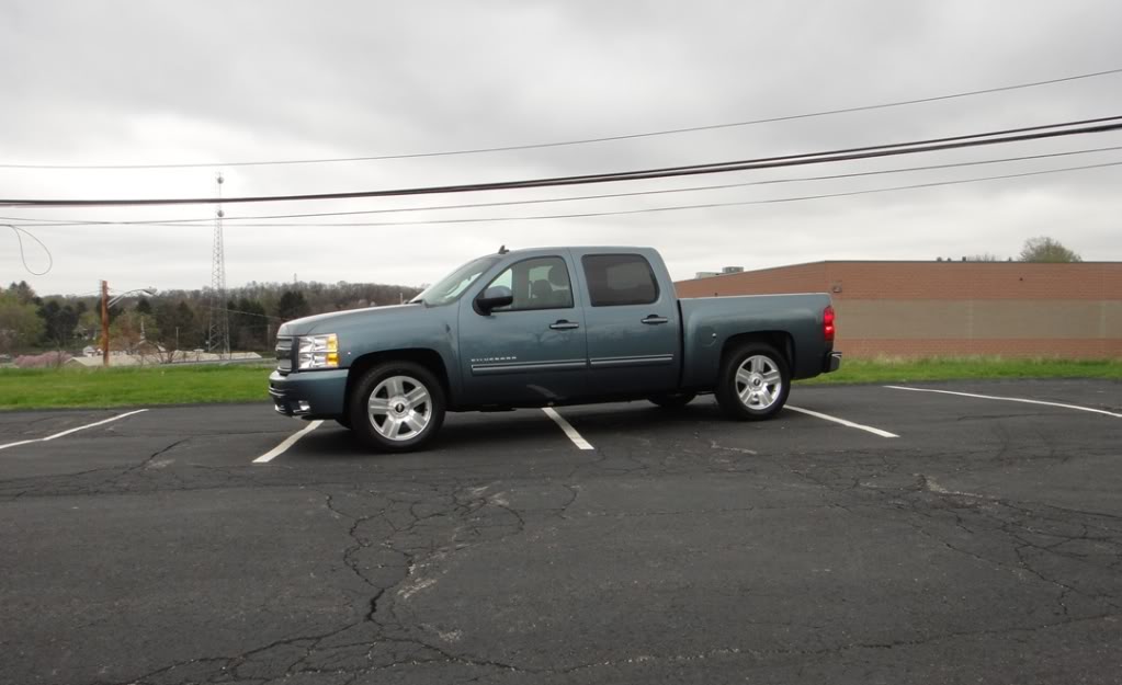

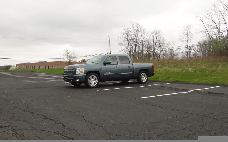

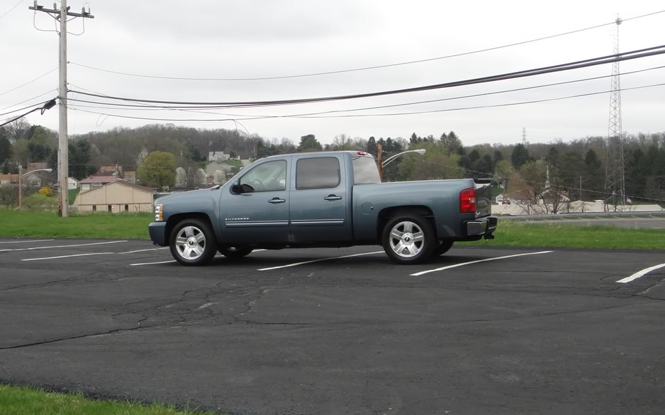

If you haven't already ordered the ground force kit... look in to some Belltech adjustable lowering struts. I loved them on my crew cab. Spindles take away too much turning radius imo. Also I think the ground force 4" is leafs iirc? I'd try to stay away from them if at all possible. I did the DJM rear flip because it has the adjustable pinion build into the flip kit... and DJM rear lift hangers to bring it back up to 4". With 2/4 you'll still have enough room in between your axle and frame to leave your bump stop brackets attached to the frame... just trim the rubber down to the last rung. Mine rode great like this and I still had the OEM Rancho shocks on the back of it. It was perfect daily driver height!
Something to think about if you haven't already dropped your truck
Couple pics just to give you an idea... not trying to clutter up your thread lol.
