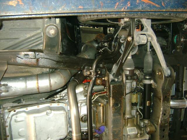

Here are the pics of the 5 inch down pipe when it was getting built...
Old Jun 12, 2014 | 10:57 PM

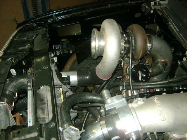

Yooooo, the turbo kit turned out great. Lets see some tire smoke now!
I have some questions about the accumulator relocation you did. I can't tell from the pics, so how did you connect the top of the accumulator to the firewall? And did you make a new suction hose down to the compressor?
The hoses right now are temporary as its really hot down here in South Texas (100+ already) so I needed something to get me by. AC works great but still need to make my actual finished lines and put them on the truck. As of now I cut the fitting off the top of the accumulator with enough material to fit a AC hose over and clamp. Its the suction side so it doesn't see a lot of pressure. The other side that goes to the compressor is basically the same except I used 2 factory suction lines and doubled them up to reach. They bolt to the accumulator and compressor like stock there just joined in the middle. That line ill have made here local since those end fittings are pretty common and the line should be easy to make by a shop. The Top of the accumulator tho will have a -12 bung welded to it as well as a -12 bung to the fitting that bolts to the firewall. Hope that makes sense.

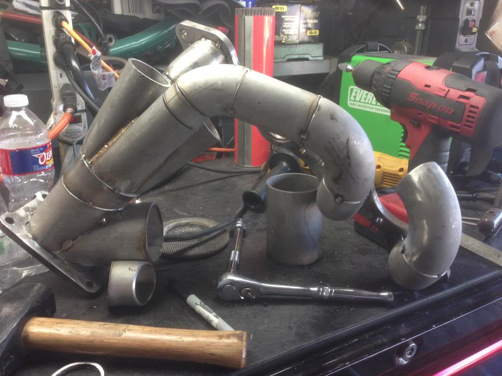

Can you post some pics of how you have the cross over joining the pass side below the turbo?

Yeah I'll try and snap one for you after work. Basically comes together right under the turbo flange and has a stub with a v band that the crossover ties into. The Wastegate is right of that y section.
Here's a pic of the manifold when I was putting it together to give you an idea...
