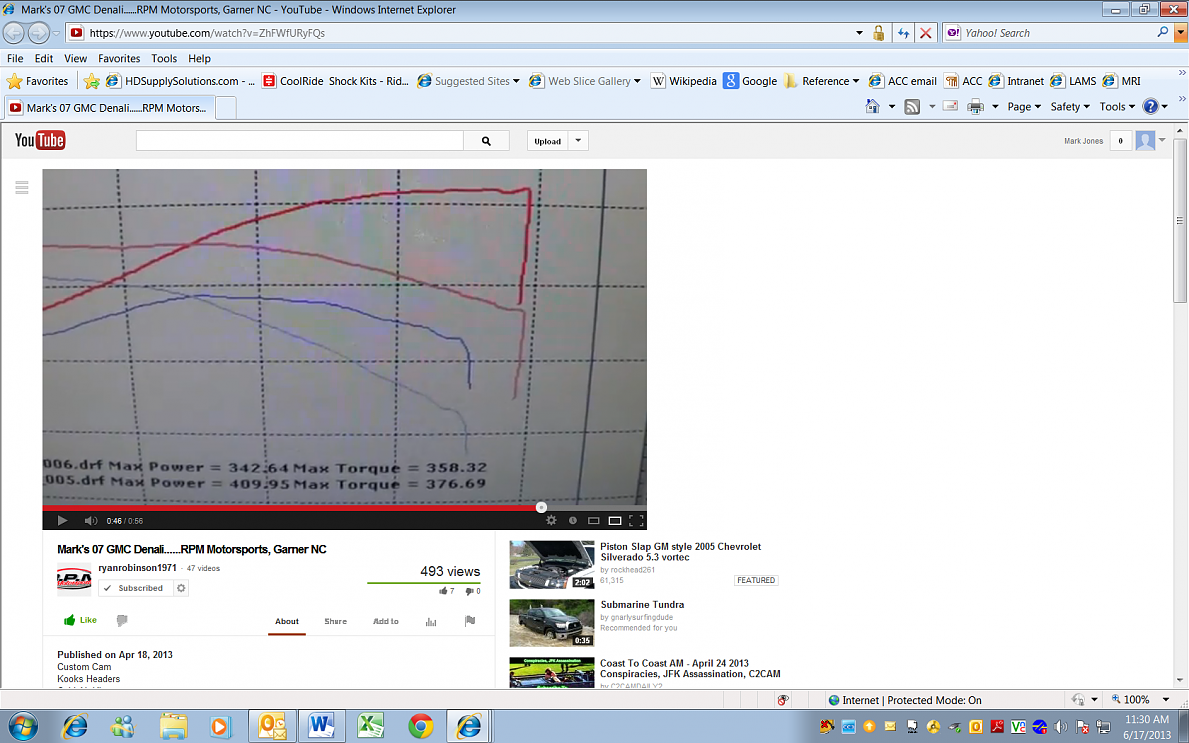

Originally Posted by GMCSIERRA5.3
^^ thanks... Bump anyone done a ported manifold on a non cammed truck
I had my manifold radically ported before my cam install. The motor turns up a good bit faster and really shines over 5000rpm's. Horsepower goes up all the way to 6500rpm. After I did my cam install with the manifold it gained almost 100hp over baseline after 5000rpm. I think it was worth it. With it ported you can stick your whole arm in the manifold and feel and of the runners. If you wait a few months I will be replacing my manifold with some forced induction and will be selling it.
