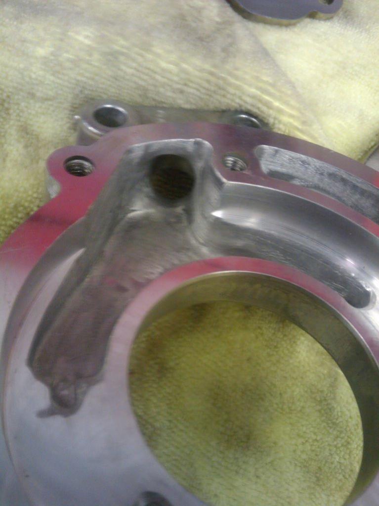

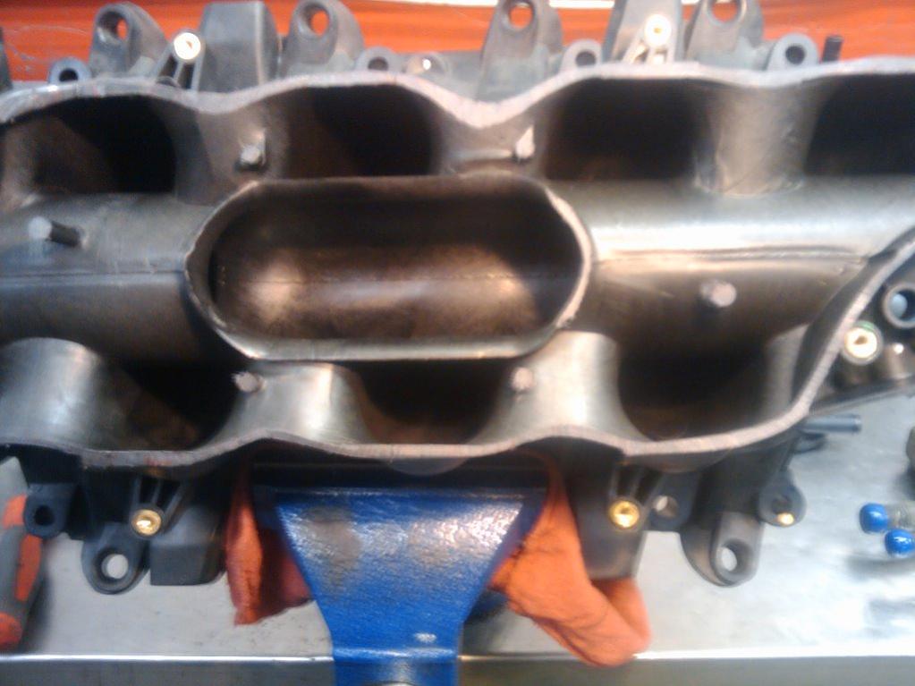

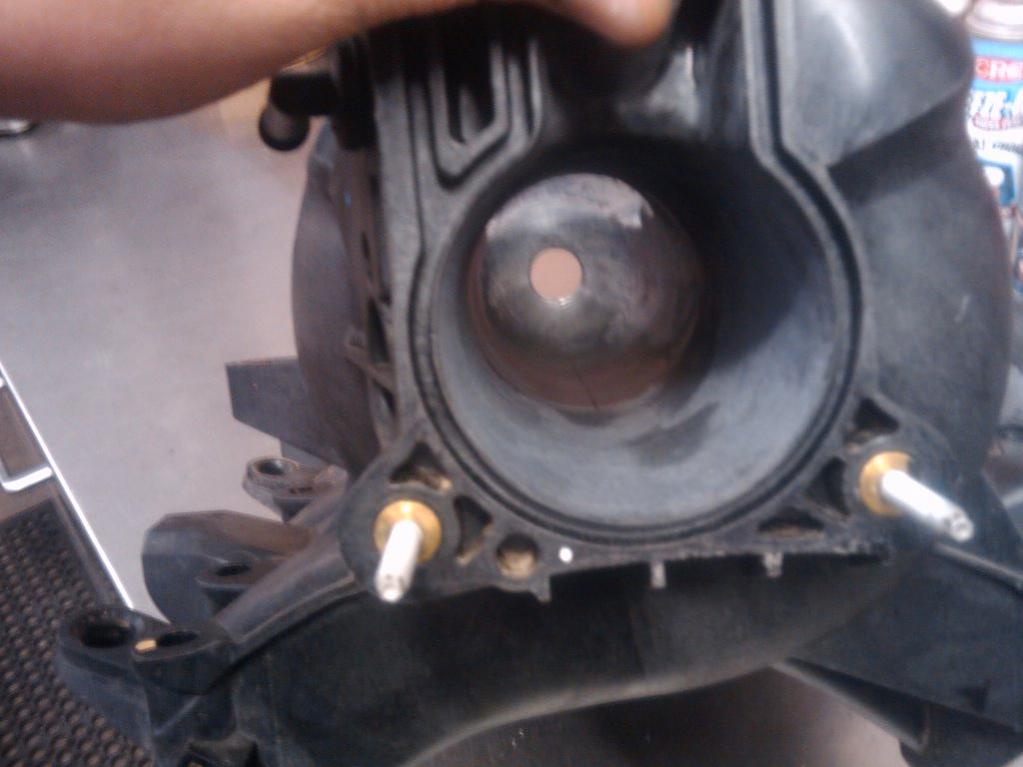

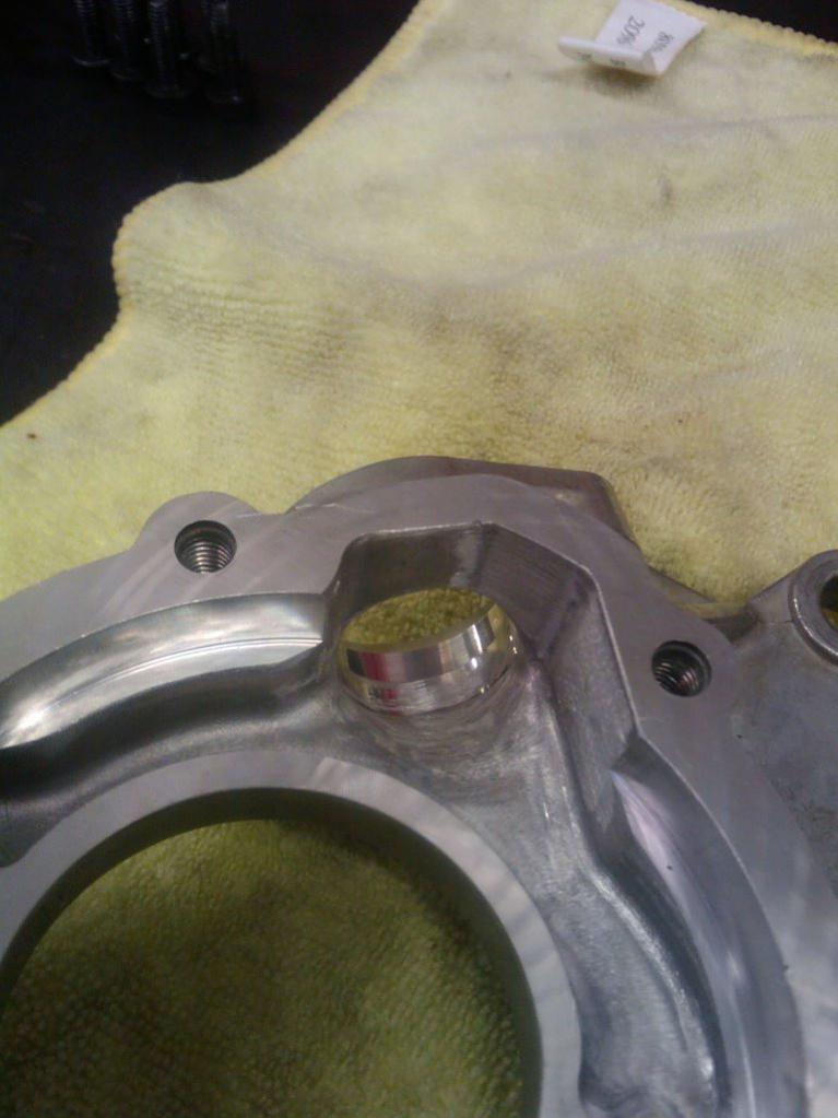

I Ported and Pollished the Oil Pump today, it was virtually new at 18K miles so i shimmed,Ported,Pollished and put it back together, should work much better now, I wanted to show one of my Truck intakes i've Cut open to fully port and pollish, i did a bunch of work i believe will pay off but we'll do a back to back to see if it was worth the work, Someone will know i'm crazy after this deal LOL But hey i don't have 1100$ for a LSXRT!
