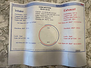

Oh by the way, here is the cam card they sent with the cam in case anyone is interested.

They gave me the same thing, but unless I am just blind I still don't see the seat to seat/advertised duration or any seat to seat specs?

Yeah, those details aren't there. Still, I wanted to post it up anyway because it shows the fact that they measure each cam after the grind, which I think is great!
