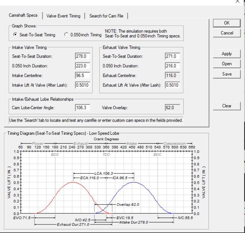

While trying to iterate through cam profiles while maximizing the torque area under the curve between 2000-6500, then moving towards 2000-6000, I find it starts to reverse split the cam:
Any idea why 68Formula? You hear the only place for a reverse split cam in the usual 2 valve large intake smaller exhaust valve type engines is with turbos, but then you hear any cam is a "turbo cam". As with the cam above, obviously no one would probably use it as a "truck cam", especially since I optimized it starting at 2000 rpms. Also that's where the stock converter will stall up to at full torque but not if the converter is locked. In reality if towing you would be in tow haul and the engine probably would always be above about 2500rpms if towing a lot, so not sure there is a point trying to optimize torque that low.
The cam above would have 7 degrees of overlap @ 0.050 and I wouldn't' think it would idle that good which wouldn't be a very good "truck cam".

Having the overlap split biased BTDC as you have, will increase low end WOT torque. However, that really doesn't reflect part load conditions. The IVC isn't bad for a 6.2L truck, but overlap as you mentioned would be very mismatched. Not only would the overlap cause low vacuum, but it, in combination with very early EVO; would make throttle response and part load soggy until your foot is virtually fully in it.
