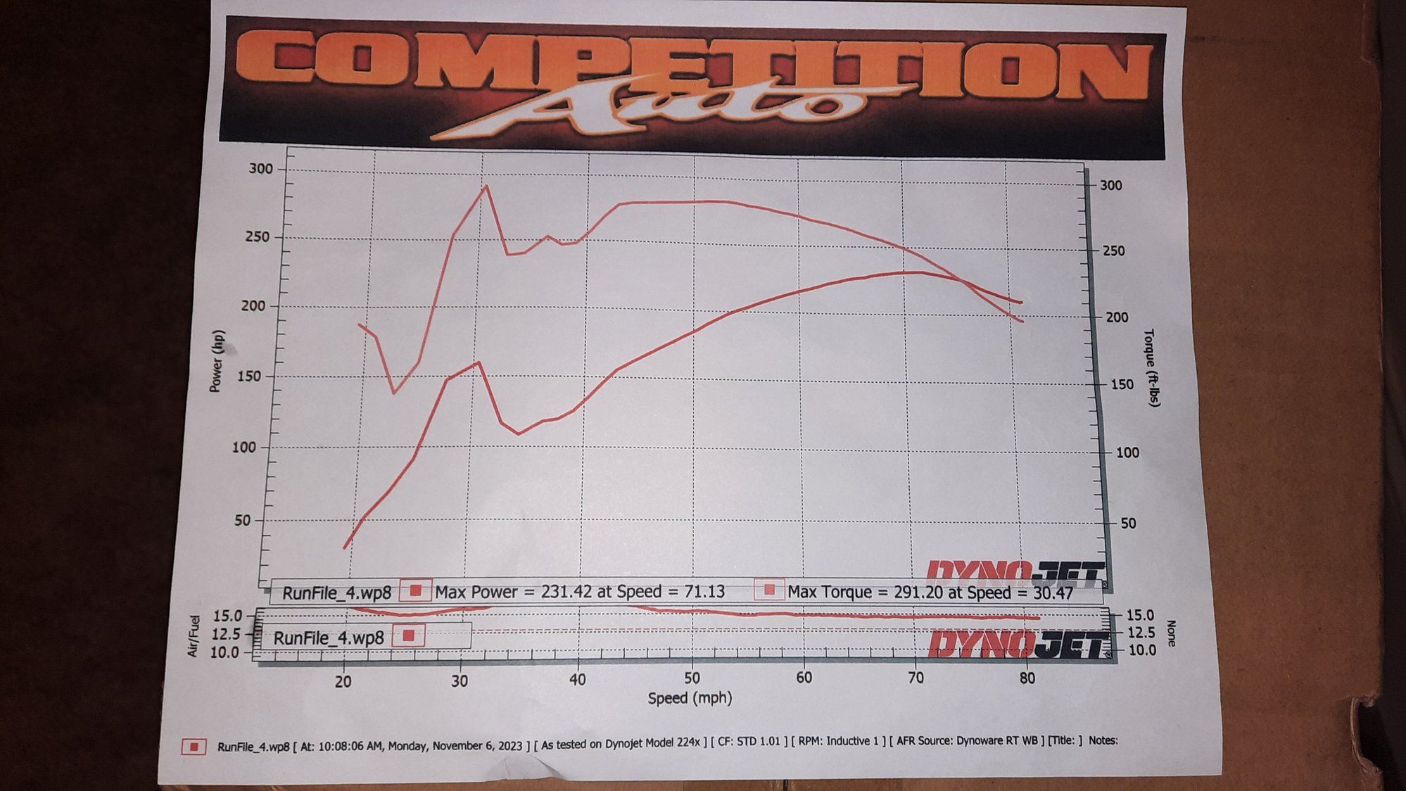

Had an appointment at the Dyno closest to my house, I need to find another dyno. They wouldn't run it over 100 citing the risk of the driveshaft coming apart. I hadn't heard of this so I googled it and only found one post where this has happened to a silverado, at 130mph. I asked them what I needed to upgrade to be able to do a full pull and they couldn't tell me, "do your research and figure out what you need to do" was their reply.
The guy didn't know how to lock it in 3rd, neither did I so I googled and poked around in VCM scan and found "command 3rd". I couldn't sit in the truck with him so I showed him how to do it and he did a couple 2nd gear pulls and then when he went to do a 3rd gear pull, it kicked back down into 2nd and he said that command 3rd doesn't stop it from kicking down into 2nd. I tried it myself on the highway afterwards and "command 3rd" only let the trans run in 3rd. Even from a dead stop, it starts in 3rd.
Anyway this dyno chart is about worthless. This is a 2nd gear pull, I know that should affect the numbers but I don't know how exactly. And the big nasty spike down low they said was from interference. This dyno doesn't really matter I just want a "before" for a stock motor. I'm assuming it should be laying down somewhere around 275 to the wheels.

If that dyno graph is from a stock 6.0 in your 2500HD truck, then it's about right, not counting those spikes at low speed. The HD drivetrain eats up the power on these engines.
It would have been more useful to see the chart in RPM instead of speed though.

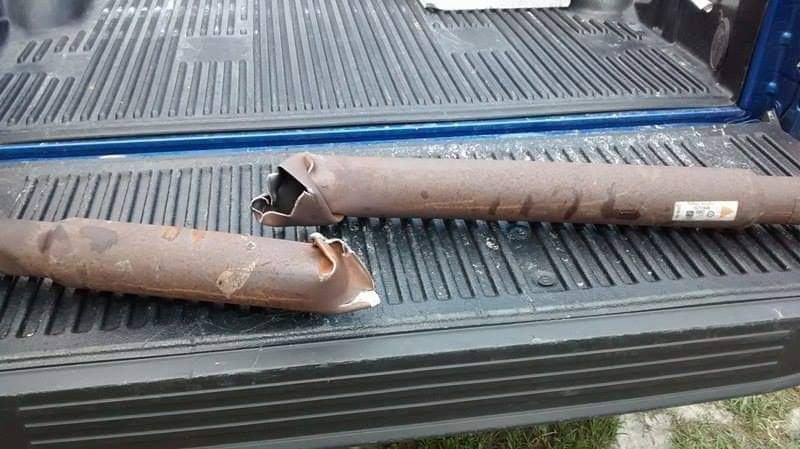

They're right about the drive shafts. They hit critical speed if you run it out on 3rd gear. Somewhere just north of 100 MPH.
Most guys just run in 2nd gear.
If you only found 1 google hit, you didn't search hard enough. There were multiple guys on here that documented blowing the driveshaft up.
https://www.performancetrucks.net/fo...ploded-500271/
https://www.performancetrucks.net/fo...eshaft-545357/
https://www.performancetrucks.net/fo...-500271/page2/
great info, thank you. Yet another thing to add to the purchase list.
