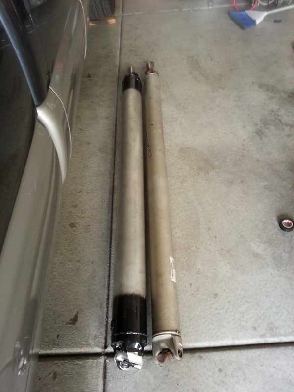

Ended up having this monster built. I asked for 4" .125 wall with 1350 u-joints. Some how they ended up building me this 5" .125 wall shaft with 1350 u-joints. Oh well I guess, works just fine and was the same price. $460 including tax. I guess if I ever end up making 2000hp, I'll atleast be covered lol

Old Aug 20, 2016 | 01:36 AM
climb-101's Avatar
Joined: Jun 2016
Posts: 56
Nice. Who built it?

Originally Posted by climb-101
Nice. Who built it?
Six states distributors here in Salt Lake.
