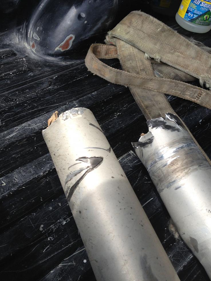

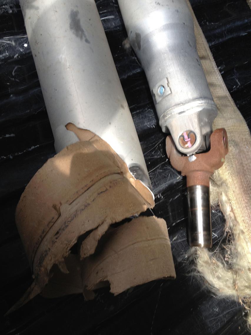

Pics up ... yoke on axle is still in it but u-joint is shattered off of it ... never found that part...

Ordered HD Aluminum driveshaft ... thicker walled shaft that does not taper from 5"-4" like the stock ones do .. 5" all the way thru... Driveshaft Specialties says thats the weak link and it is the exact part that blew apart on one end of mine...
