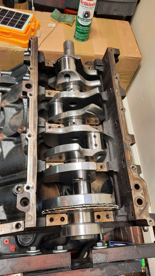

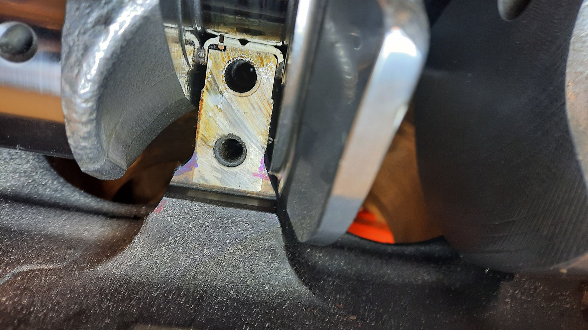

Clearanced the block enough to be able to set the L8T crank in. This iron is actually really easy to grind with a cheap amazon bit. I assume I need .060 between the counterweight and the main web that carries the thrust bearing?

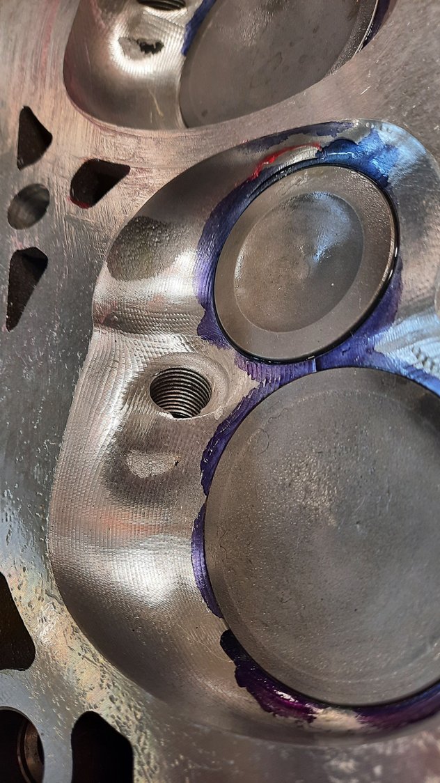

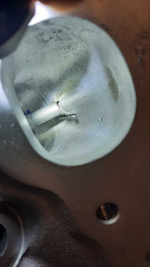

My ported and polished 823 heads got done months ago, finally unwrapped them. Measured at 73cc. Machinist installed BTR valves and 660 springs. The comb chamber is rougher than I expected, I thought softening a head meant you ended up with a really smooth surface.
I need to figure out the deck clearance but it's looking like I'll be around 10.7:1.
