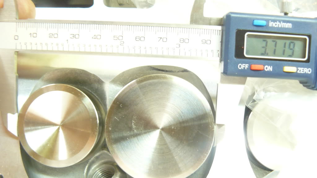

Default I'm trying the same thing.
I just posted a similar question over on the LS1 site. I have a set of 243 heads with 2.02/1.57 valves that I'm thinking of putting on my 5.3. After measuring across the valves the width is 3.720 from one valve across to the other valve. In a 3.780 bore that leaves .060 or .030 from the edge of each valve to the cylinder wall. That is if everything lines up perfectly. I seems really tight but I'm not sure what an acceptable clearance is. I'm waiting for someone more knowledgeable to chime in and offer an opinion.

From: Calgary
Here's a pic of the 2.02/1.57 valves showing the measurement.
I might just notch out the cylinders for these valves. I will decide today as I'm going to start my blower installation.

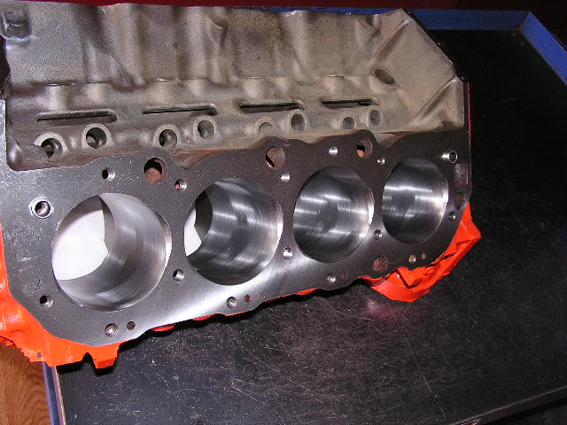

Old Aug 2, 2010 | 12:37 PM
swift700's Avatar
Joined: Jun 2010
Posts: 938
From: Calgary
This is a fairly common practice for tight valve-to-cylinder clearance. I lifted this pic from another site but it shows the reliefs ground in:
I think this is what I'll do for the added clearance safety margin. It also improves flow by unshrouding the valve somewhat.
