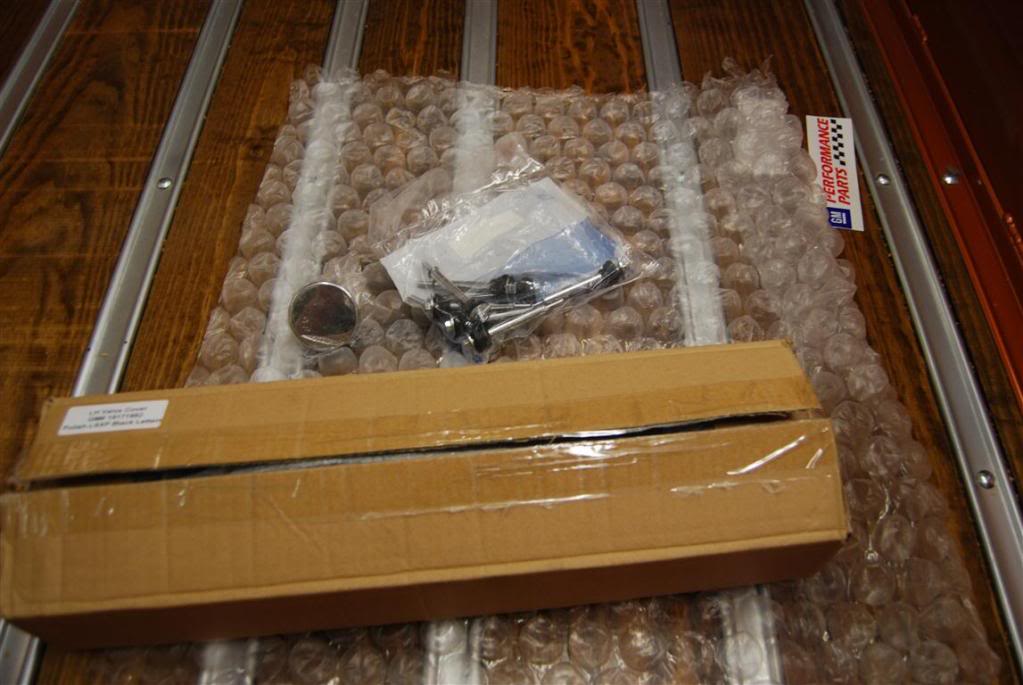

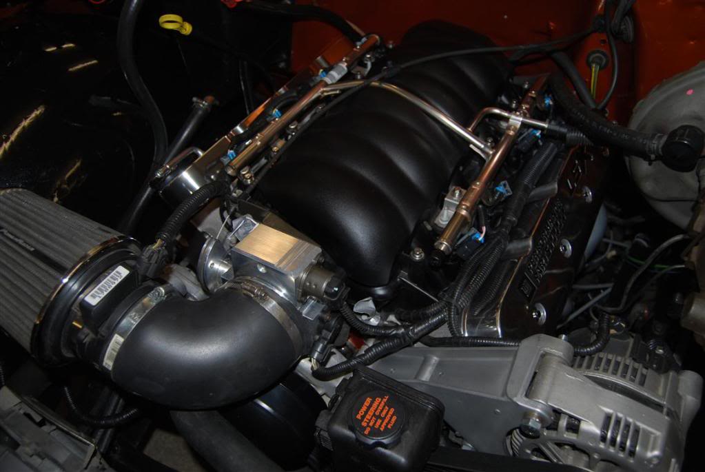

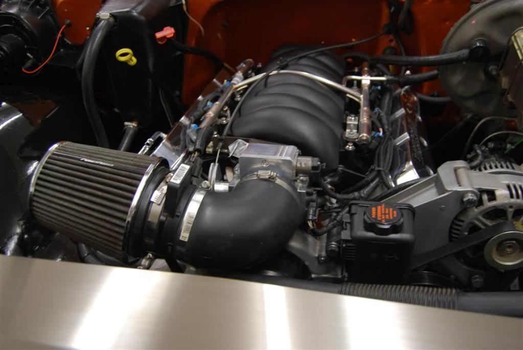

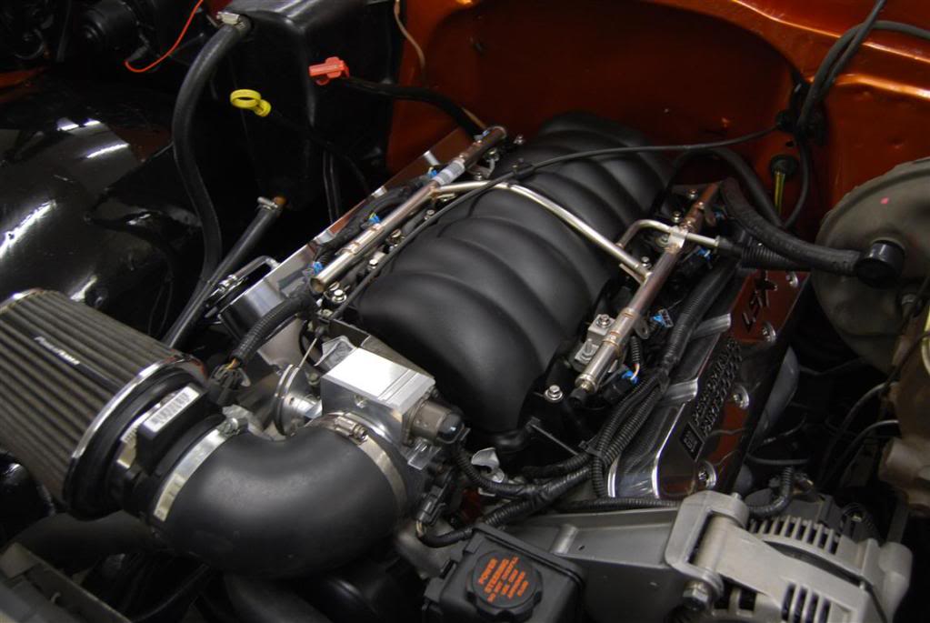

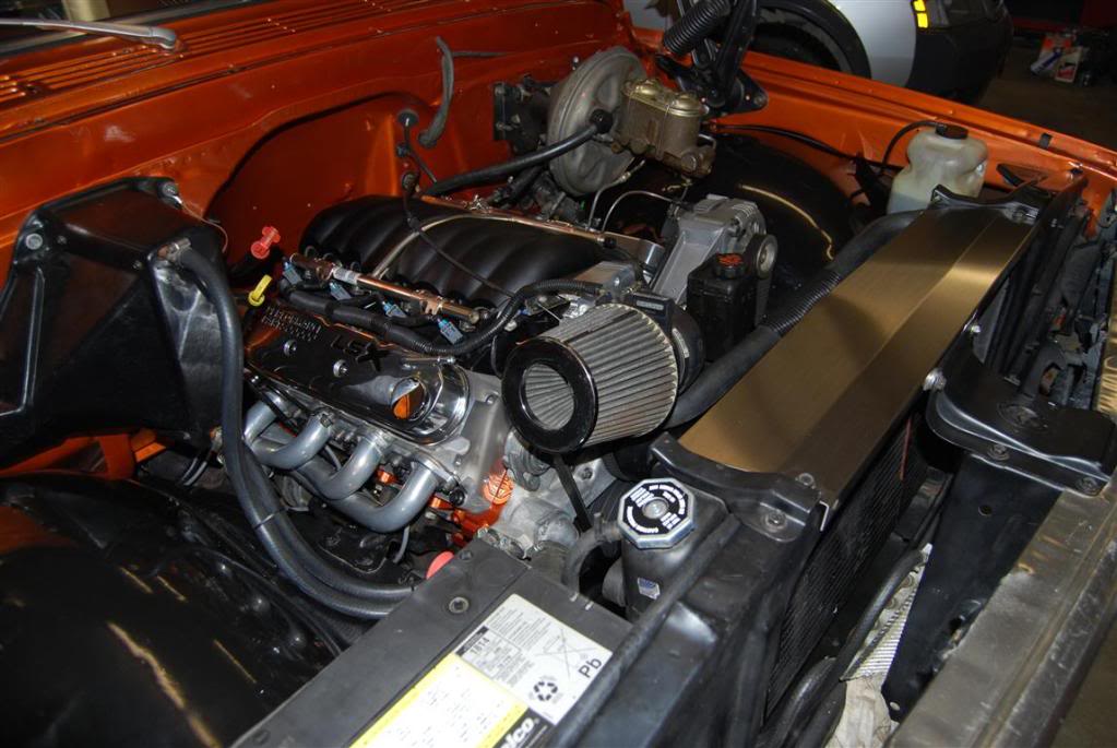

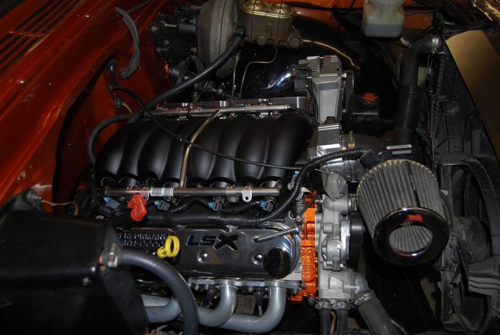

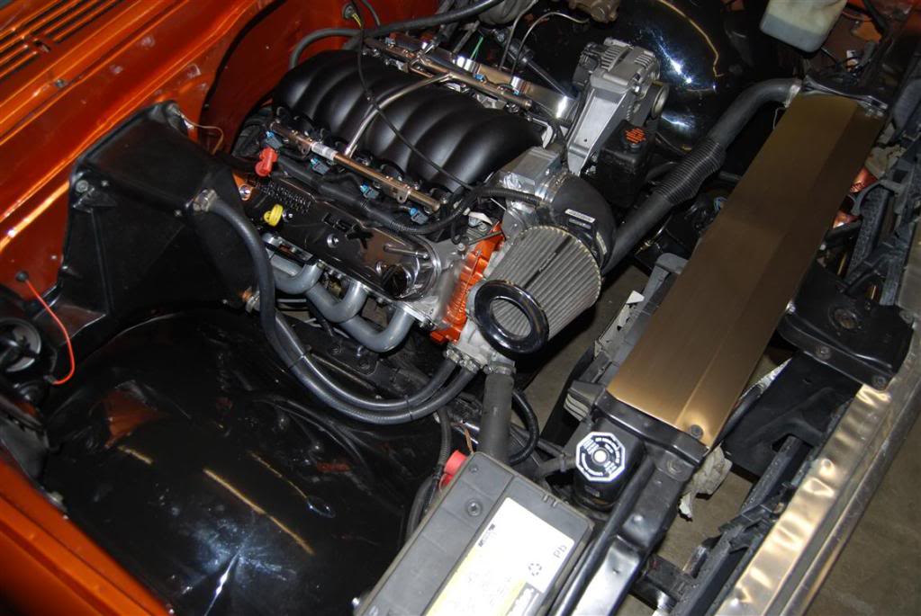

- - - - - - - - UPDATE!!!! - - - - - - - - - - - - - - - -
Lots of new parts!!! Got the GMPP Valve Covers!!, Harmonic Balencer, New HB Bolt, 96-99 Vortec Plug Wires, New ACdelco Irridum Plugs at .040, 2 Gallons of Antifreeze and some ATF.
-Relocated the coils to the frame rails on either side of the engine, back. Ran the 96-99 Vortec truck wires that I got from the cheap parts store for 29.99. Somehow they work fine with the LS1 coils, I'll buy the MSD Universal wire kit (32079) later. It was a trick using the 90 degree plug boots with the headers, but with carefull routing and zip ties it worked out.
-Installed the new GM Peformance Parts LSX Valve Covers, they even came with new chrome bolts and chome oil fill cap which was super nice. They really set off the engine!!!
-Installed the new Crank Pulley/Harmonic Balencer and new bolt.
-Reinstalled radiator and antifreeze.
-Installed new Polished Stainless Steel Radiator cover, looks really good I never had anything to cover the radiator before and it looked really bad.
> Finally I got to test start it again and let it run for a bit although it was a bit late...so I only ran it for a couple minutes but everything sounded great and the sqeel and clicking was non existent... I'll get a video up when I start it up again tomorrow.
Things I need to do is buy a proper cold air intake pipe of some kind and get a new upper radiator hose so I can run the intake over to the drivers side, maybe use some type of aftermarket air box or open filter.
