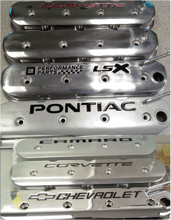

hey matt, i see you used stock valve covers, did you remove the oil baffle plates on the underside? i had to remove all over them cause my rockers would hit.. just a thought didnt know if you removed any of them..

Ya I removed that oil baffle and I ground down some aluminum parts inside the valve covers. Seems like they don't fit right, so I just set them ontop of the heads to keep oil from getting all over everything.
--- The GM Performance Parts Valve Covers are still on order they will be here next week I hope! That will make it look so much better!
These? (GM Performance Parts LSX) They're sweet!
Yup! Those are the ones!
