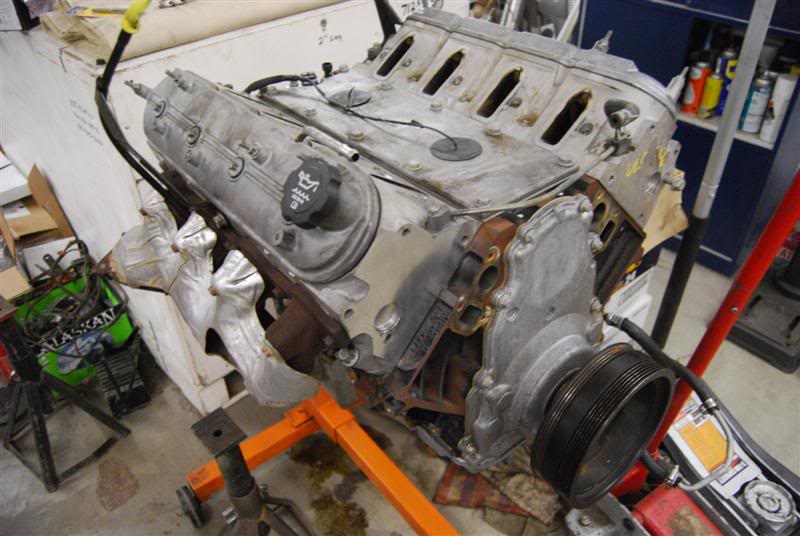

I decided to start an engine build for my 69' C10!
Current for those of you that don't know it has a cammed 5.3L with a Comp LSR 215/223 .604/.610 lift on a 112 lsa and upgraded valve springs and many other small things. Don't get me wrong it runs great but I want a bit more power.....
To start the build I decided to buy a used good running 2004 LQ9 6.0L from a wrecked Cadillac Escalade, I test started it on the engine stand with a hacked together wiring harness and it ran good. Did a compress test highest was 200 psi, and lowest was 190 psi so it seems to be a very solid engine and very clean. I pulled some of the accessories off to start the tear down.

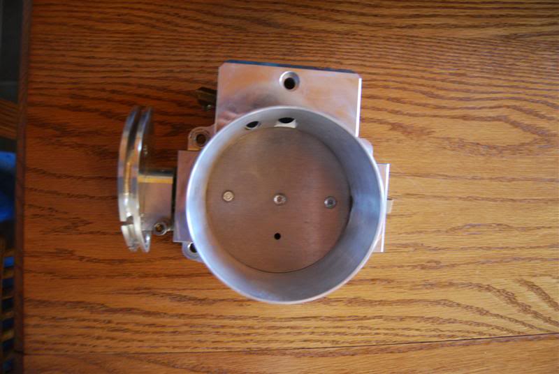

Got a good deal on a 90mm Cable Throttle body off Ls1tech, here's what it looks like:
