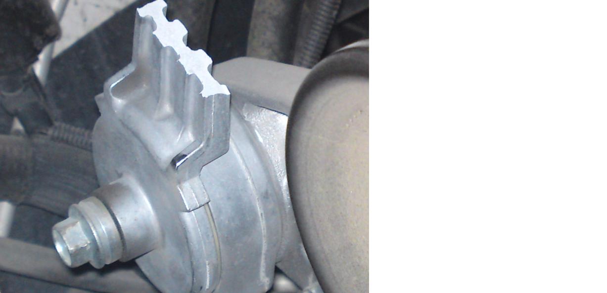

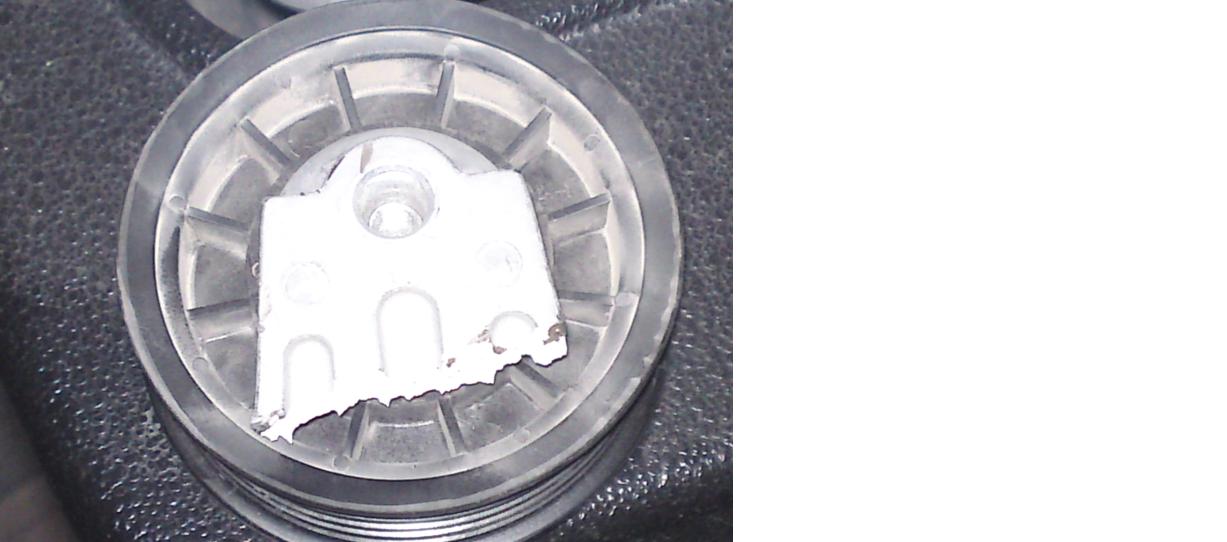

i was trying a new transmition tune and testing my car shift point and sudenly power steering went out , i stoped emidiatanly and i saw the belt out and a pully with half a bracket lying around and the tensioer base broken into half
why did this happin any idears
i dears how can i get another one

my belt popped off a few days ago, but the tensioner didnt break. I am upgrading to the hd tensioner sometime soon, might want to look into it. magnacharger and any of their dealers sell it.

can you give me a link please for the product cause i did not find any thing and is all 5.3 and 6.2 tvs tensioners are the same

I couldnt find it on their website either but if you call a dealer they should be able to hook you up. Its around $130.

i see that i have a defrant type of tensioner maybe its defrant for type for the new engines cuse it looks alot defrant
i asked a frined in the states magna a call
i will dismantel it soon and i will see what can i find
