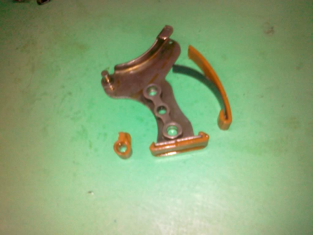

For any newbies like me (DOD delete)- Do NOT use the Gen 4/LS3 tensioner on any modified engine they're a piece of junk. I think the best option is the LS2 wedge type tensioner. Freakin $30 part is causing me major problems. Failed at 3000 miles after the cam.

Old Jun 5, 2011 | 02:03 AM
supercharged680's Avatar
Joined: Sep 2009
Posts: 948
From: Dubai, U.A.E

In my case the front of the engine started making a horrible squealing sound. I thought it was the Magnacharger tensioner at first.

Because its not part of the DoD system. VVT trucks also use these. And it also helps GM validate the engines for 200,000 miles by eliminating slack as the chain stretches.
I suspect if they make an "adjustable tensioner delete kit," the LS2/3 chain dampener would be an important part...
