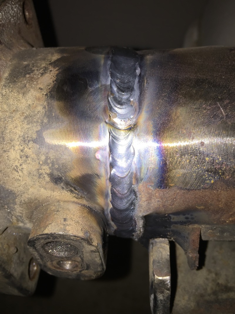

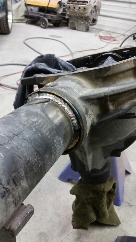

All i have to do now is clean the tubes out, start putting it back together.
I have all new parts for the rear end. My tru-trac looks great, no slack so it'll go back in with roughly 60-65k of abuse on it
The oil that came out when i pulled it apart, didn't have any shavings or anything so i feel it'd be fine.
I am relocating the shocks to the rear, so lets hope that goes smooth.
What degree is most people running on their relocated shocks? I am not running an adjustable shock yet, as i just want it back on the road.

So did you cut the tubes off where it necks up by the center of the housing?
