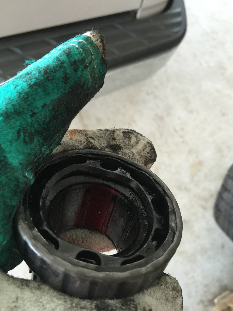

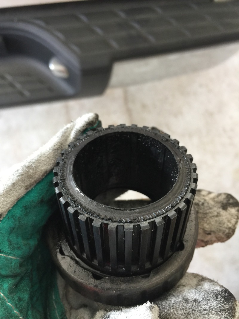

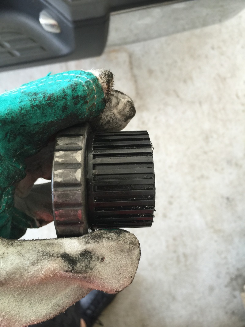

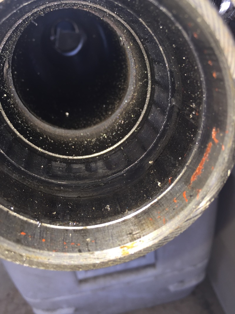

Im going to do some measuring and stuff before i assemble both sides to see if i could have cut the tone ring down to get away from having them inside the tubes or not.
