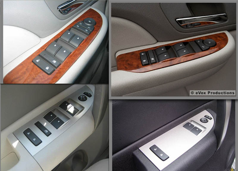

Well its possible, the only way to know for sure is to pop the switches off and look. GM even had a SB on the whole situation, their way of checking to see if mirrors could be added/swapped was to see if the Tech II could "talk" to the door modules, thus confirming the databus style. No mention of cab configs or option packages.
I added the signal mirrors to my RCSB, I have since found out that many of them did not come pre-wired for it like my truck did so who knows what GM does at any given point in time.
If you want a copy of that SB PM me with e-mail address, can also get you wiring info but there is no breakdown for cab styles, only for individual options. Given that a crew cab has four doors though I'd bet it IS databus since that would be easier to route than wiring harnesses, but I would make sure before ordering mirrors off e-bay. Also, those folding mirrors have a different switch assy, it has an extra button for the folding part and different style adjust button.
Pic attached. The upper two are databus style (notice the one is missing the folding mirror button) and the lower two are plain old wiring as far as I can tell. I had looked into adding the folding mirrors to my RCSB but decided against it for now as will probably trade in when the 6 speeds come out. In my case it requires new switches, mirrors, door panels, harness and programming (the door panels are nicer style too actually). I did all my research based on my truck so not sure about ext/crews.

If you have the RPO codes that can help too....AN3/DL3 trucks are databus equipped. I can get schematics too if you wish, they show crewcabs as both databus and good old fashioned wiring. PM if you want them.

Sorry, true enough..I was just looking at wiring diagrams...
I think the AN3 is the power seat with programmable positions?
