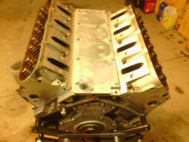

Here are some pictures of the 4.8 valley cover I installed this weekend.
PN 12598832 I believe. Was $28.28 from GM parts direct.
I did not plug the oil holes in anyway prior to the cover. The oil pressure bung in the back clears the LS1/LS6 intake manifold as well.

I'm just curious as to why the valley cover is different than the one that Forcefed86 has pictured? With the black plastic cover on the underside.
I'm looking to do this very soon as well as swap cams. I think this will help with my misfire situation.

just wanna say thank you for posting this. I just did a cam swap on my 08 and used the part numbers you listed, saved a lot of time. thank you.
