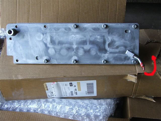

will a traditional LS6 valley work?

Once you see one you'll understand. You need a smooth one without the oil passages and what not.

random google pics but you can see the huge differences

the 4.8 cover doesnt have the pcv tube sticking out of it and its 1/3rd the cost of the LS3/7 cover

Was just curious because i already have an ls6 valley covet, thanks guys.
