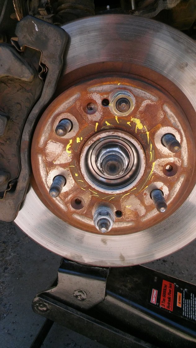

Hey guys- anyone have any pointer for an axle nut that just will not let go?
TIA
Old Jun 29, 2017 | 04:23 PM
  #36
FFDP's Avatar
Joined: May 2014
Posts: 5,282
Likes: 600
From: Rogers, MN
A long pipe on a breaker bar.
You can also blast the nut with a little map gas torch to heat it up and it should break free better.
Or a stronger impact gun.
Old Jun 30, 2017 | 01:32 PM
  #37
Mark Johnson's Avatar
Joined: Mar 2007
Posts: 1,728
Likes: 29
From: Santa Fe New Mexico

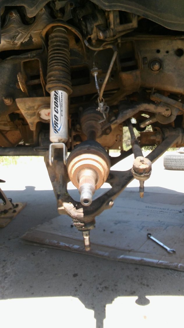

Thanks FF- coaxed it a little with a blow torch and got the nut off. Got the spindle off, too. Went ahead and took off the UCA. Now the big question- do I really need to unload the torsion bars to remove the LCA?
TIA
Old Jun 30, 2017 | 05:09 PM
  #38
Joined: Mar 2007
Posts: 1,728
Likes: 29
Old Jun 30, 2017 | 06:59 PM
  #39
ILuvJDM's Avatar
Joined: Feb 2007
Posts: 954
Likes: 59
From: Austin, TX
No, by that point its completely relaxed, or at least it was on my truck
Old Jul 1, 2017 | 09:22 AM
  #40
Joined: Mar 2007
Posts: 1,728
Likes: 29
Got down there, looks like there's still a good bit of tension in everything so I'm gonna borrow the tool. BTW JDM- yer truck looks pretty fawkin righteous, what's your total drop.............
