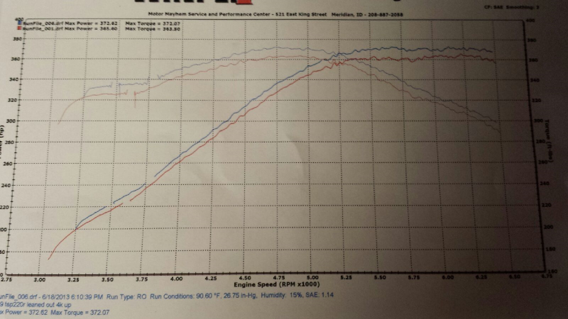

heres some one with a similar truck as yours on the dyno. and he added a tsp220 cam.
https://www.performancetrucks.net/fo...-graph-519133/
Old Jan 28, 2015 | 06:06 PM
Fast_six oh's Avatar
Joined: Apr 2014
Posts: 180
Those are impressive numbers, my truck has the factory dual 2.75" exhaust..wonder how much difference there would be between that and his 3.5" single?? I wouldnt think too much..which cam would you pick for my application? The lunati 217/223 or the tsp 220??
