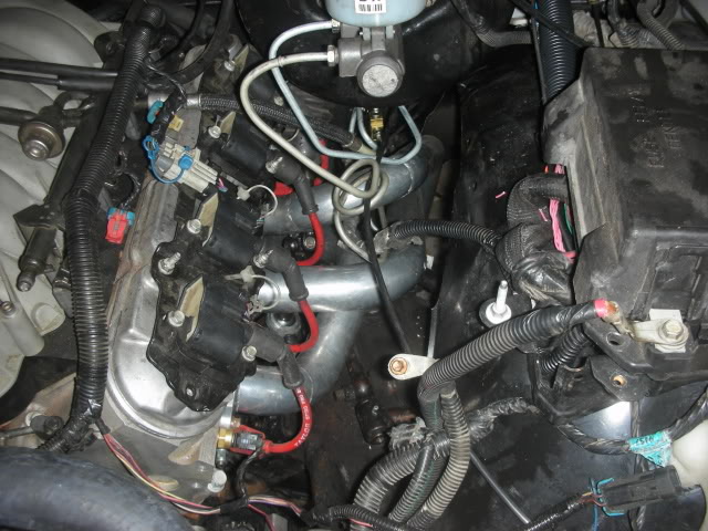

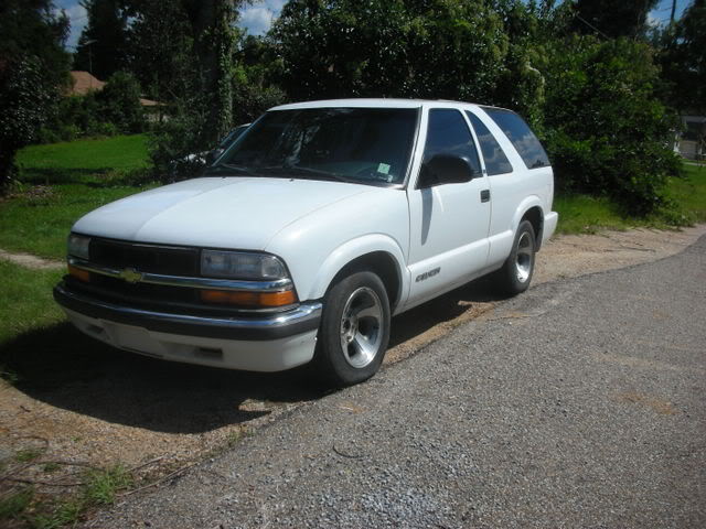

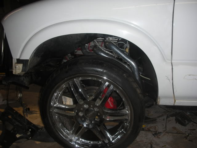

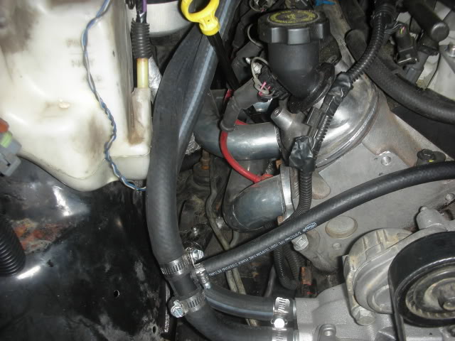

pm me if you want my number or have questions... i have done it and learned the ways of it.. i build mine to look good and run great... 1 7/8 long tubes equal length and all

that makes me wanna remove the ac on my regular cab
