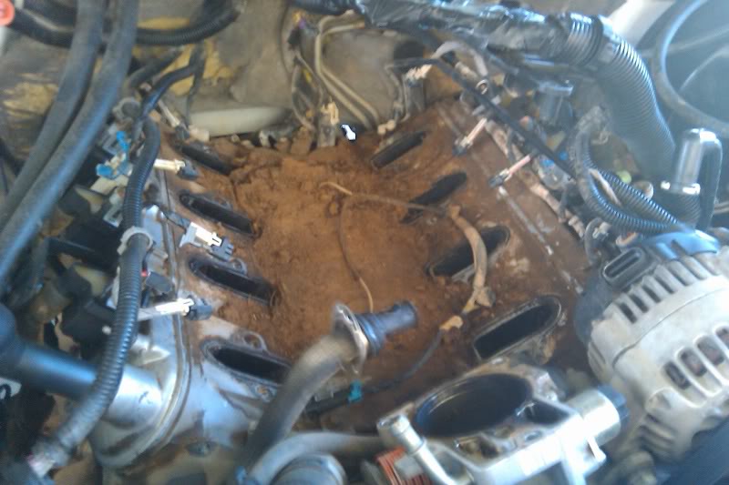

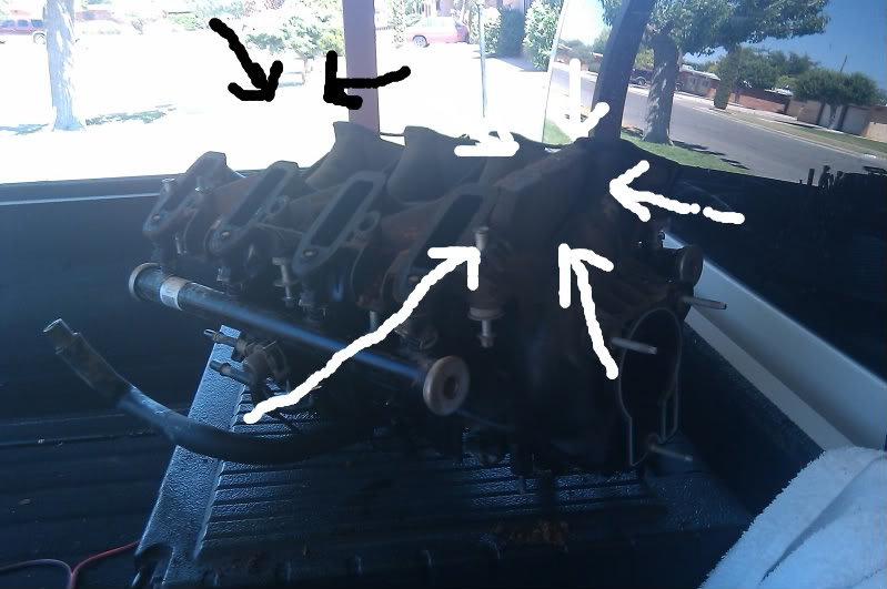

I did mine not too long ago, Half of texas was under my intake Manifold. Make sure to buy some high temp silicone while your getting parts at the store. You will want to make a small moon shape bead around the knock sensors with the opening to the moon facing the rear of the truck, this will keep water from leaking into the boot of the sensor and causing it to fail. Make sure to remove the foam blocks on your intake mani and throw em away!

GM's little dam idea seems kind of cheesy to me. I always clean the grommets up good with brake cleaner along with the holes the knock sensors go in and then apply a fairly thick bead all the way around the grommet. Pop the grommet into the hole and the excess silicone pushes out and forms a ridge all the way around the grommet. Then I shoot some silicone in around the wire where it passes through the grommet as well as a small mound around the wire itself. I've never put the little dam up and never had an issue with my method. You can still get the grommets back out but it takes a little prying. I found this out when the parts guy dropped one of the knock sensors without telling me about it and the next day it stopped working and I got to do the job over again.

That will work too. Did you remove the foam blocks from the intake? I know GM installed 'em there to keep water and mud out but from what I have seen It just keeps it in.
Sure did. It also traps heat in there which leads to intake warpage.
