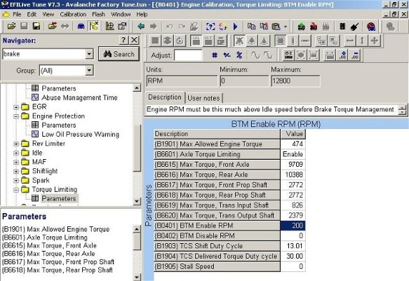

The electronic throttle control(ETC) vehicles have "Brake Torque Management"(BTM) which will limit throttle opening if your foot is on the brake. This can be disabled in the tune.

Originally Posted by dkubricht
so does that mean I cant power brake too? does that also mean I cant do a burnout?
There are also several other "Torque Management" and "Abuse Management" parameters in the factory calibration that limit power output under various conditions. WOT launches would be one of those conditions.
