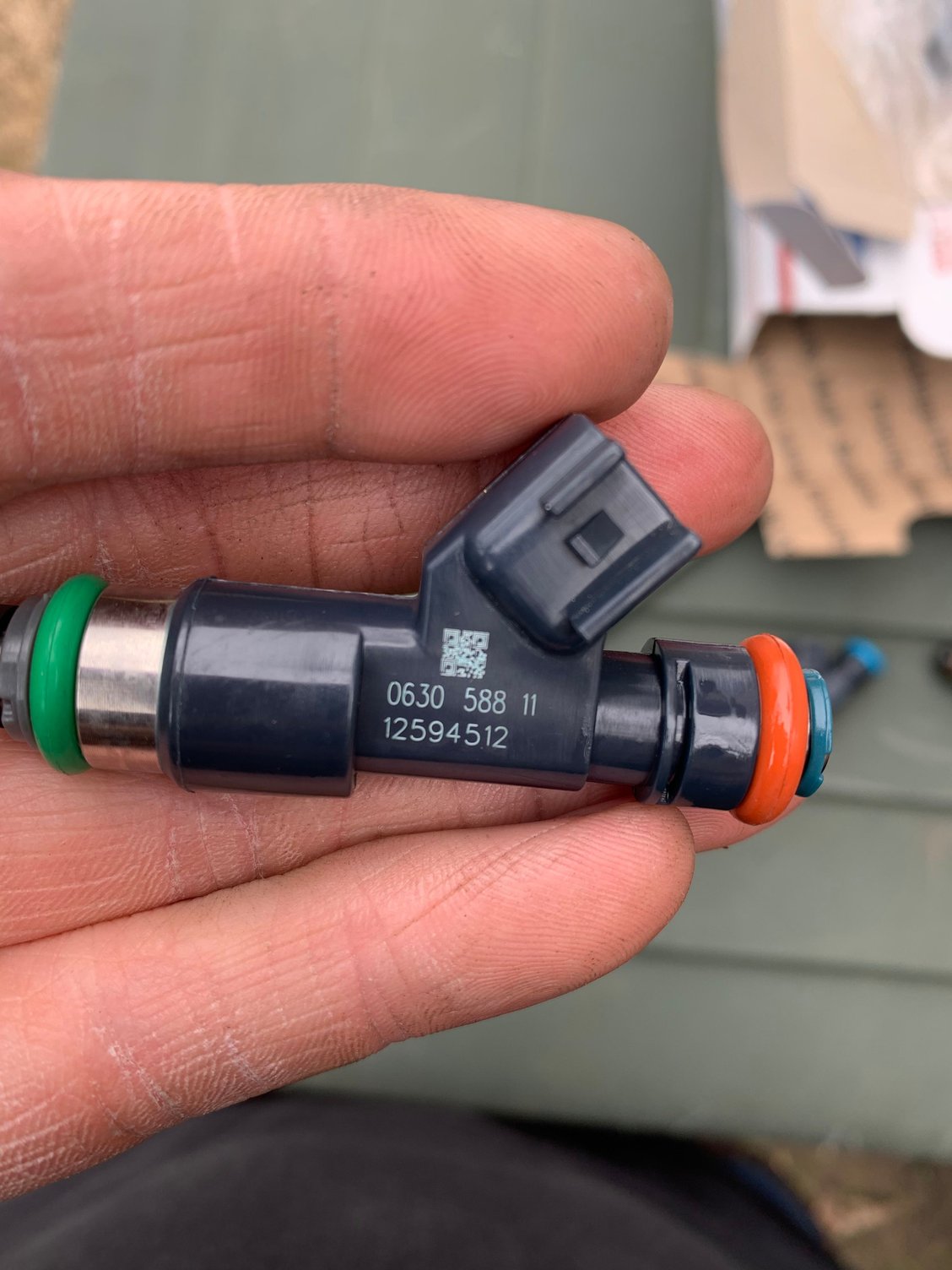

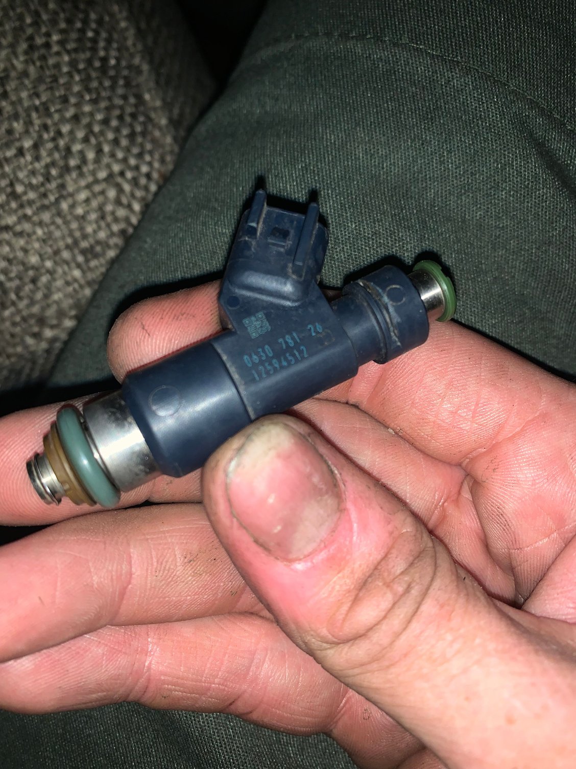

Follow up question guys… what are the top numbers on injectors above the part number? I got a new set of injectors but the numbers above the part number are different. Original injectors are 0630 781 26 followed by the 12594512 part number but as you can see in the attached picture the top numbers are different. Anyone know what those mean?

I don't know what those numbers mean. As long as the part number matches, you should be good.
