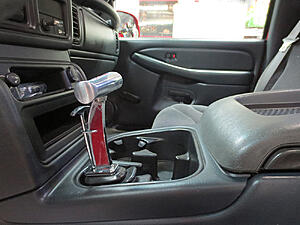

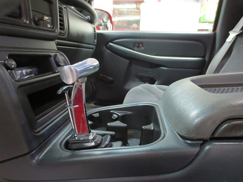

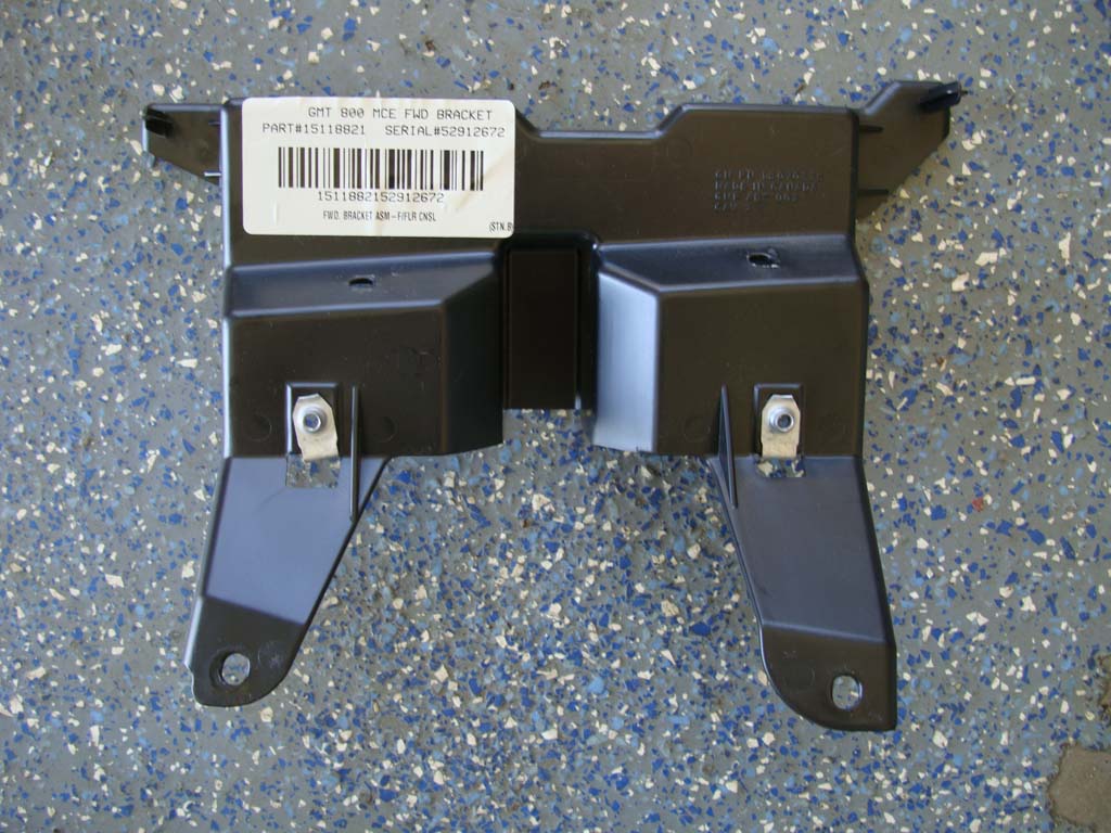

Did you use the bracket that ties the console to the dash... Part Number 15118821
My 03+ console fits perfect against the dash in my 2000 Sierra.

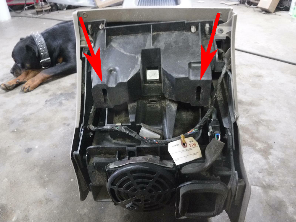

When I took my console out of a 2004 Tahoe I made sure to get that bracket that ties the console to the dash. My 2000 Sierra had no console. With the bracket It has two vertical slotted bolt holes with 10mm bolts. You simply lift the console until it bottoms against the dash and tighten them down. Without the tie in bracket the console has to stand on the two flimsy metal legs that bolt down under the seat bolts.

is that a mega-shifter in there?

The console is not lifted off the carpet anywhere along the front or sides. Those flimsy metal legs can not hold the front of the console to the dash by themselves mainly because of their lack of strength and their mounting positions being so far rearward relative to the console. I can push hard on the front of my console and it stays mated to the dash bezel. Without the bracket pushing down will simply bend the legs and open the gap wider. Yes I'm a member there but I've been inactive a few years.
Photo showing the thin metal legs especially toward the front/dash.

Here is a random photo where I added arrows where that bracket ties into the dash. You can see the adjustable slots that use two 10mm bolts. You simply adjust the gap closed by pulling up until the console meets the dash bezel then tighten the two 10mm bolts.
