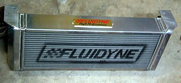

If you really want to put a bigger heat exchanger on, then check out the JDM heat exchanger made for the Lightning. But at $465, you might find a better ways to spend the cash.

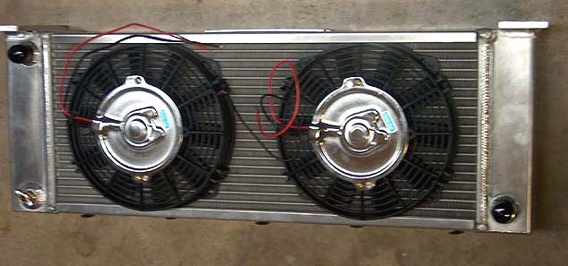

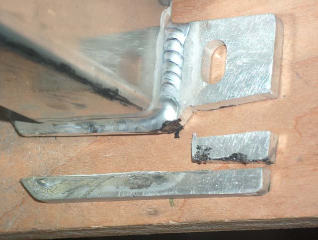

Had to grind the mounting ears a bit to make it fit in my SS.
Looks pretty cool, lurking behind the lower grill opening on my SS. Not sure what you could do for air flow on your truck.
I wish I could say what this upgrade did for performance. Unfortunately, I did not get my intercooler coolant temperature gauges setup until after I had the larger heat exchanger in, so there are only subjective comments to be made. The one thing I did notice, is the quick cool down after a full throttle run. In hot weather, the stock heat exchanger (I had the small one) would take a long time to get the coolant temp back down. So there is at least a stop light to stop light advantage to a better heat exchanger. The electric fans help in this regard as well, since you can be cooling down while stopped at the light. One measure of the effectiveness of the larger heat exchanger, is that with the engine off and the electric fans and pump running, I can cool the coolant down to ambient in less than 2 minutes. Handy for cooling down at the track.
