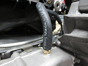

Does anybody know how to do a throttle body bypass and what I have to do if I’m using the v6 radiator? Any help would be greatly appreciated
For a clean look I just bypassed back to the water pump.
Drill Bit & Tap Drill Bit & Tap
Brass Fitting Brass Fitting
Hose
Drill Bit & Tap
Brass Fitting
Hose
thank you for the help it really cleared this problem up for me!
