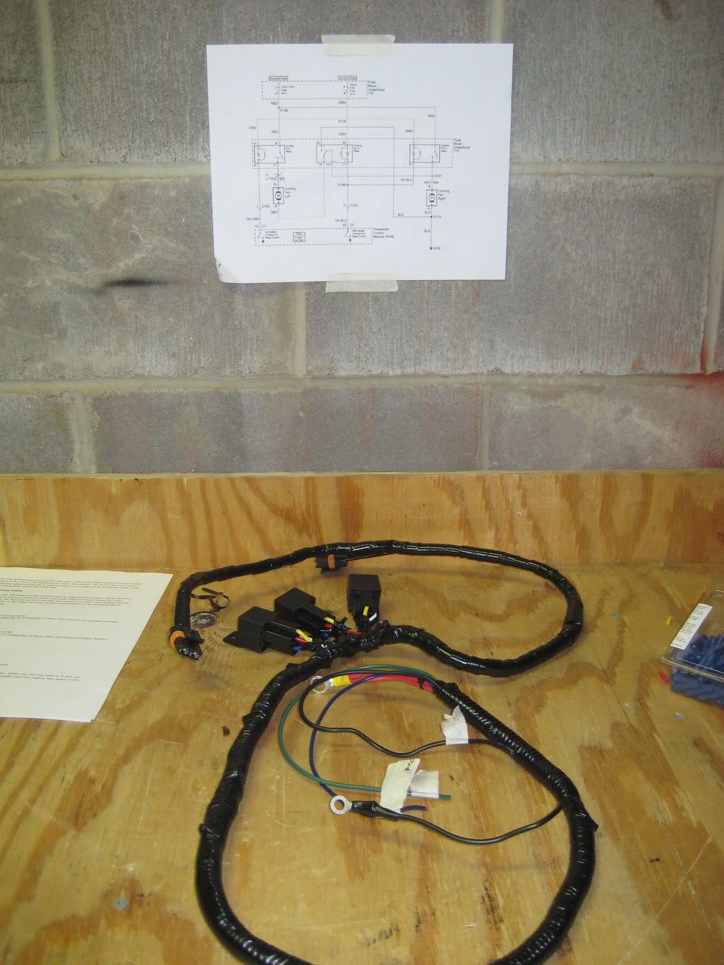

this is the one i used
I added the bottom part if you want to do it manually
cost of making my harness was about $40 for all the parts, took about an hour.
Yeah, i should have built my own. Mine has messed up twice now.
Old Jun 5, 2009 | 12:38 PM
Made a slight change to my diagram, the middle wiring for the switch should be ground, not 12v. I remember I had to do that when I installed it, but never changed my diagram.
miller, its really not hard man, just follow the lines and connect the dots.
