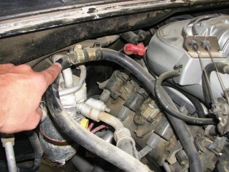

well to show you how simple this mod is i have attached a pic for anyone who doesn't know what im talking about.. if it works for ya then go ahead and install the valve...
PS.... took this pic just before cleaning engine bay

I need to do this, the A/C in my Crewcab sucks!
