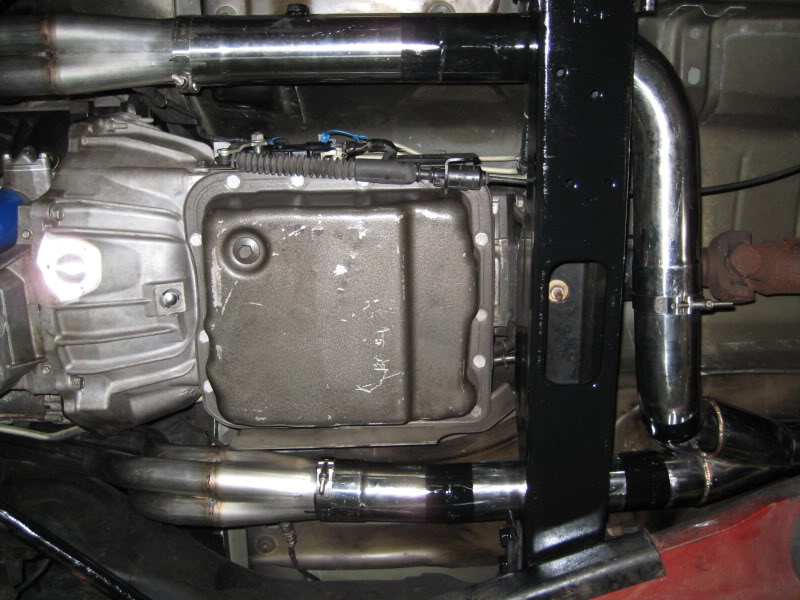

Do the slots. The reason it isn't sealing is due to shitty fitment. The slices will take care of the voids, will get you a complete seal, once they are compressed around the pipe..
I know I post this up alot, but I used the T clamps, slices when I made my Y pipe, it has held, with out a single leak or issue for over a year now.. Lap joints work fine when the fit is correct
