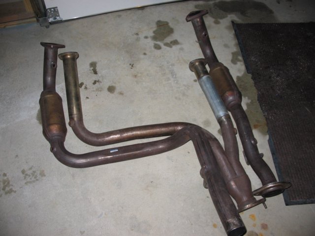

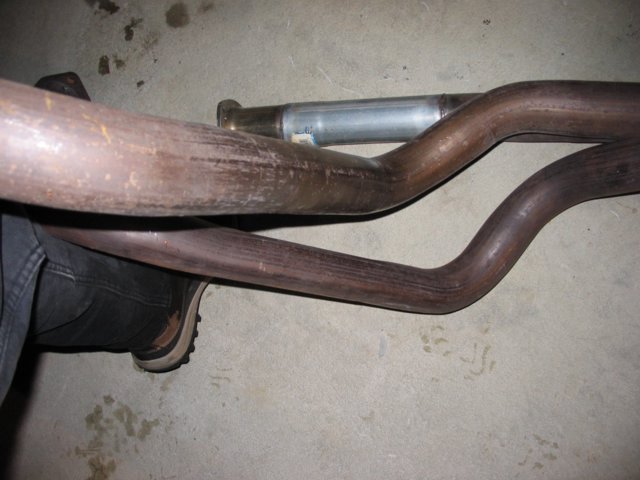

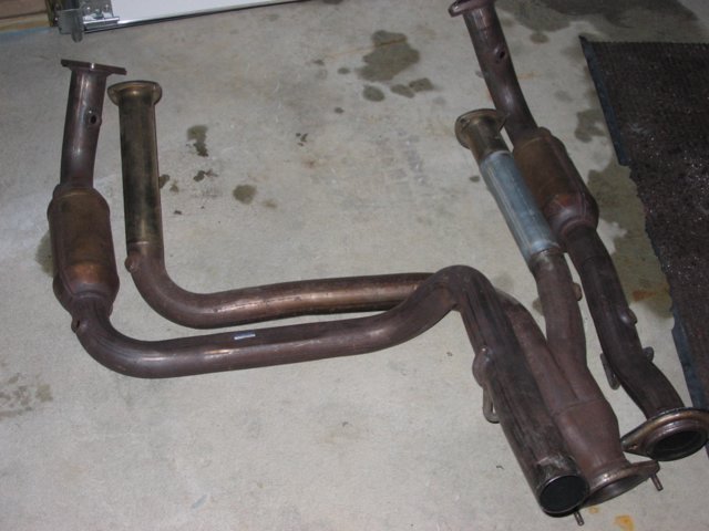

Just thought I share some pics of My 5.3 "Off road" pipe compared to cat pipes off a 6.0 1500.
The Y-pipe isn't squished like the 6.0l???

What I meant was
The factory y-pipe on My 2wd 99 step side was not crimped. Although every other year Truck, (Including my 03 Sierra) That I have seen is crimped or squished. Maybe I just got lucky with the 99.
I just was posting pics of the two pipes I have next to each other.
The 99 5.3 y-pipe VS the 6.0L SS cat pipes I just got.
The only modification I did to the 99 pipe was eliminated the cats and welded flanges for the long tubes.
Just posting info,
I'm in the process of installing a complete dual 6.0l system on my 5.3 Z71.
Hopefulluy I'll have a 6.0l in it soon so I'll be ready with the exhaust.

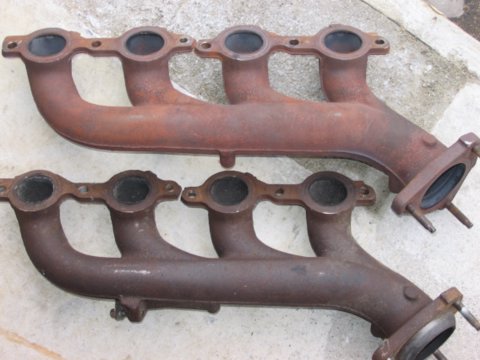

I got the 6.0l manifolds today and I thought I'd share some pics of the differance between the 5.3 and 6.0.
The 5.3 and 6.0 "driver" side manifolds are almost the saem except the outlet on the 6.0 is slightly larger but
The pasenger sides differ at the collector flange. The 5.3 has a donut/floating flange and the 6.0 has the fixed flange like the drivers side.
here's a pic of the 5.3 pas side VS the 6.0 Pas side;
The 5.3 lines up with the 6.0 catpipe but don't know how ell it would seal,
Heres the two side by side, The 6.0 being on top

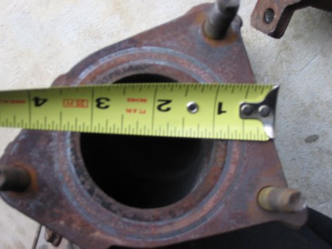

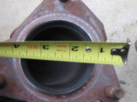

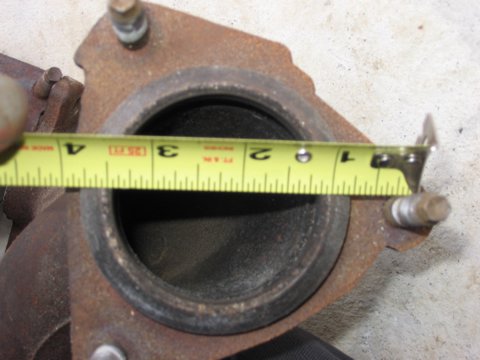

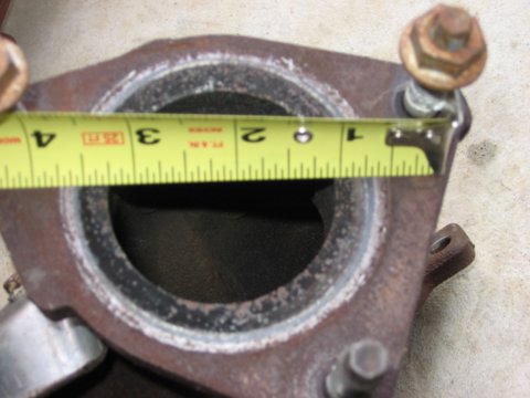

Yes I measured them all and took some pics.
6.0 Driver side outlet approx 2 1/2 ID
6.0 Pasenger side outlet approx 2 3/16 ID
5.3 Driver side outlet approx 2 3/16 ID
5.3 Pasenger side outlet approx 2 3/16 ID with donut
give or take a C hair
The casting look the same after I took the heat shields off with the excepting the 5.3 has egr.
The 1st pic is the DS 6.0
The 2nd PS 6.0
The 3rd DS 5.3
The 4th PS 5.3
The last is the 6.0 vs 53 pas manifolds
Attached Thumbnails 5.3 ypipe vs 6.0l Cat pipe-ds-60.jpg   5.3 ypipe vs 6.0l Cat pipe-pas-60.jpg   5.3 ypipe vs 6.0l Cat pipe-ds-53.jpg   5.3 ypipe vs 6.0l Cat pipe-ps-53.jpg   5.3 ypipe vs 6.0l Cat pipe-ps-53v60-2.jpg
