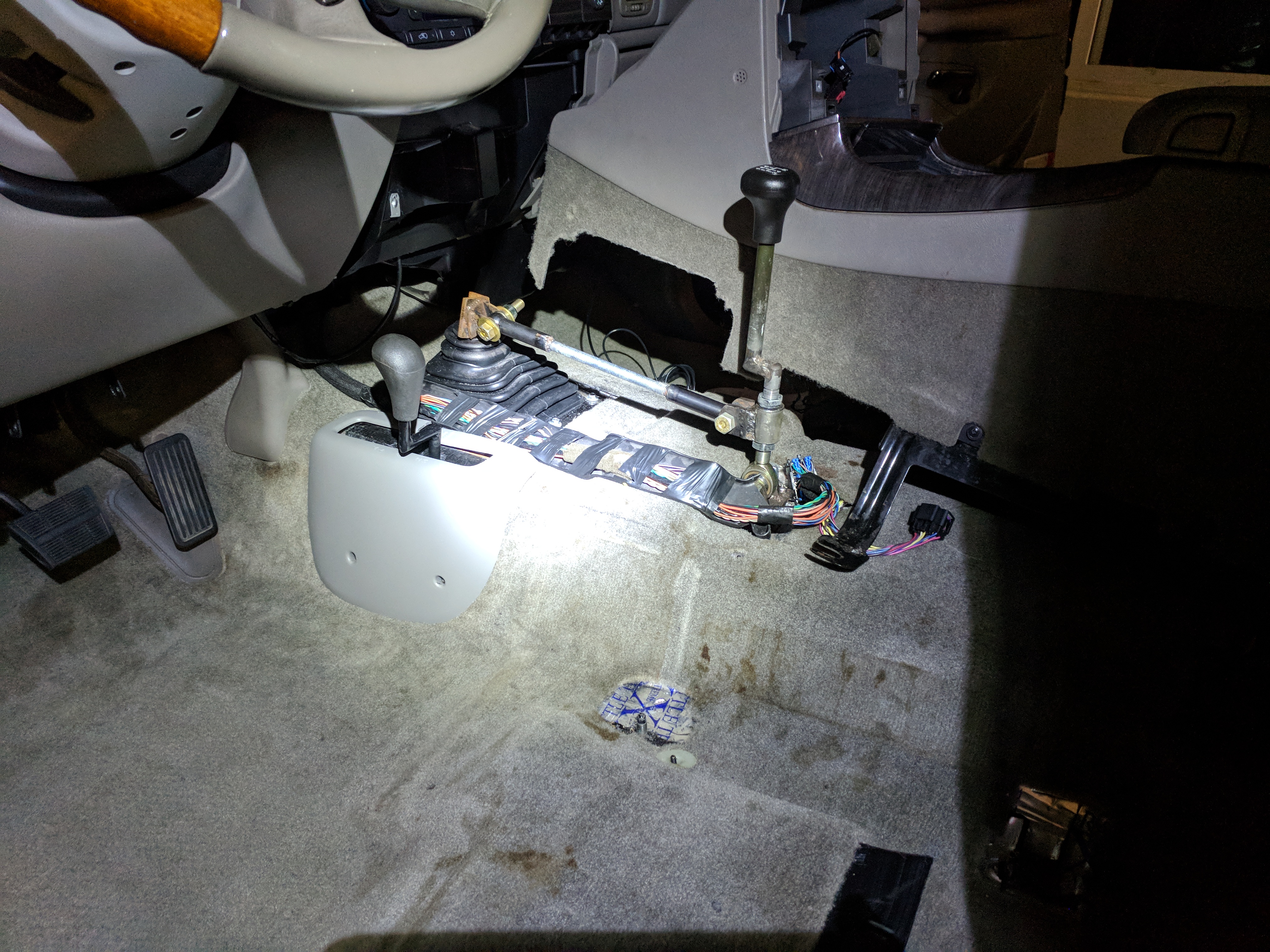

Originally Posted by Chevy305
Glad you like the core shifter.
Could you post up some pictures of how you are configuring the center console?

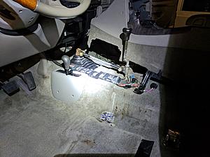

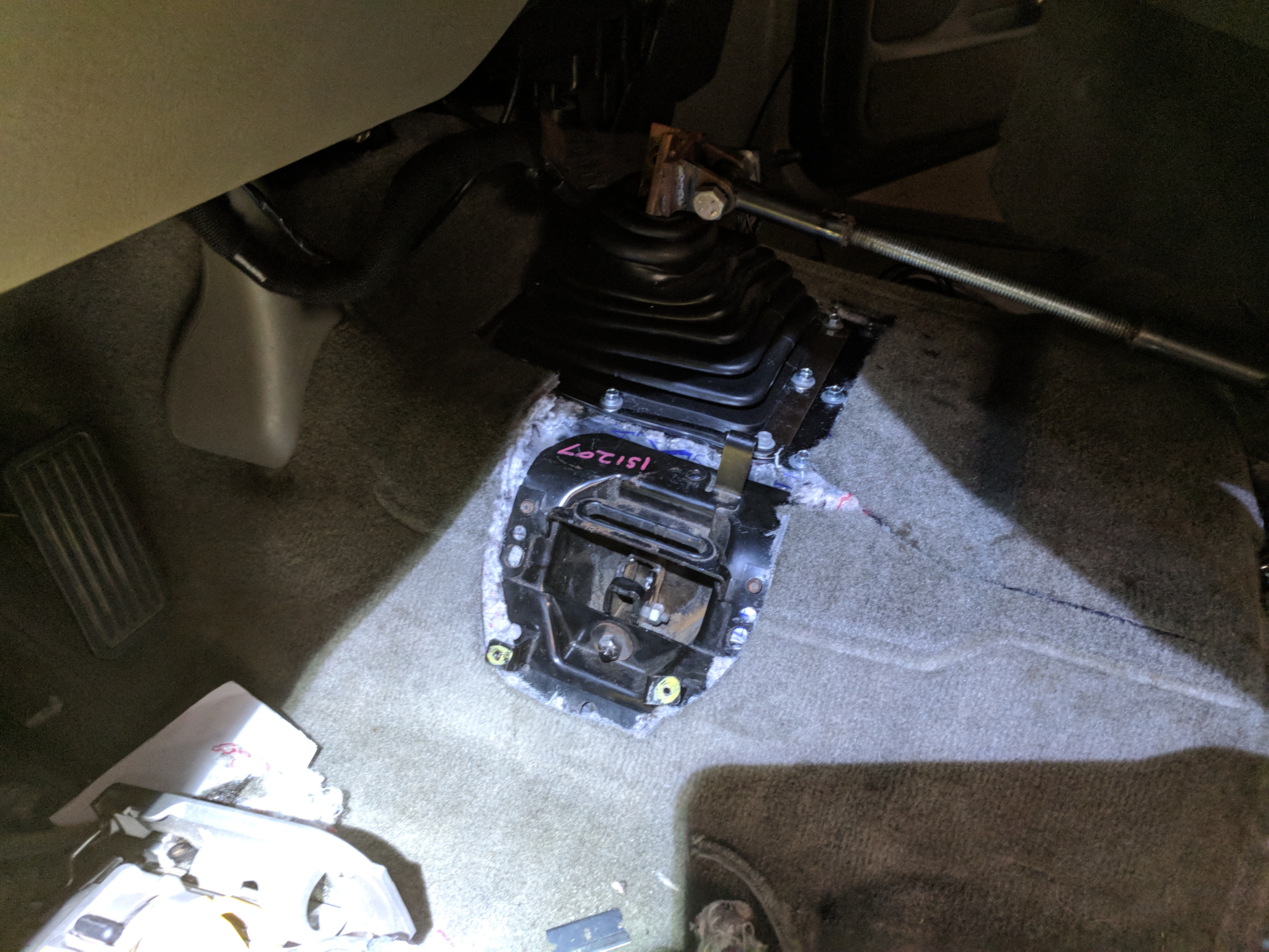

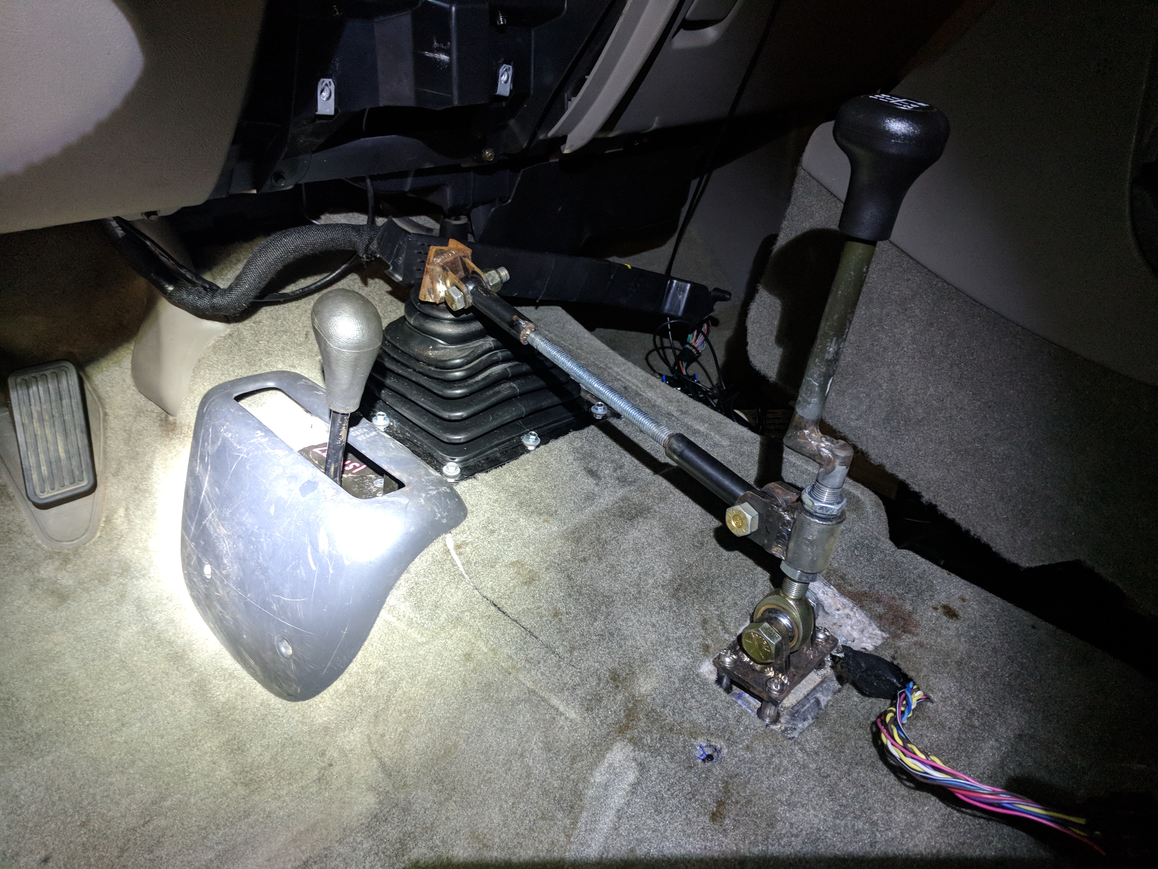

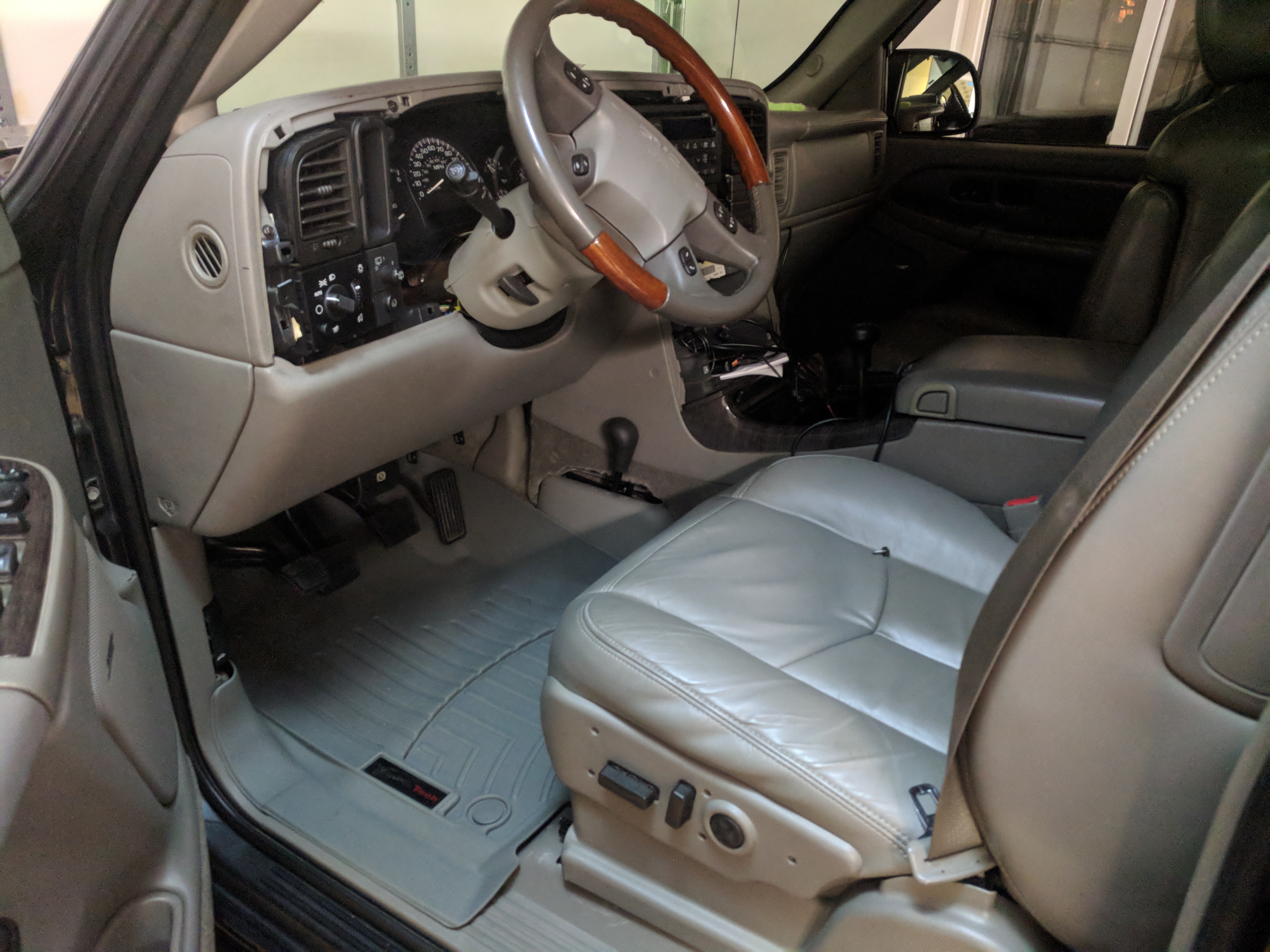

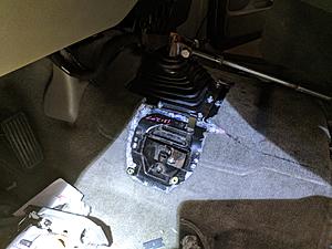

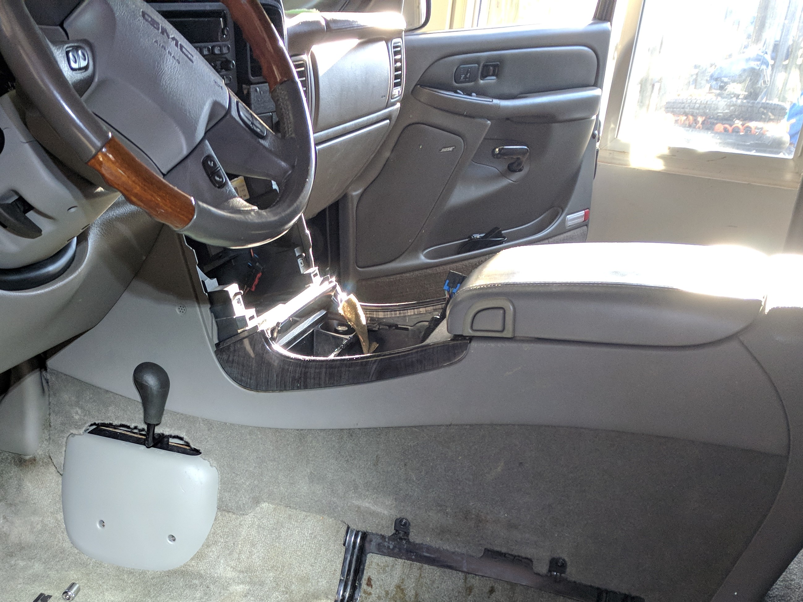

Here are the pictures I have right now. I am working on modifying the top lid of the console to include a shifter boot so it looks more stock. Almost done.
