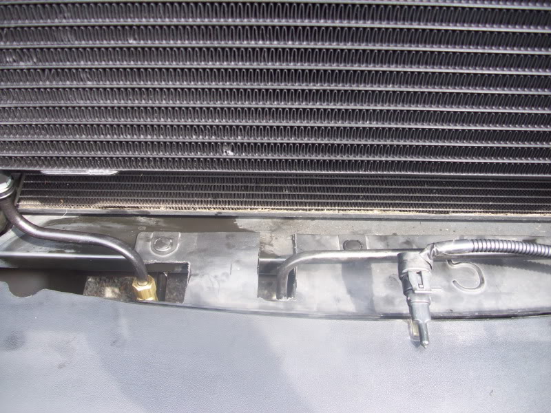

Anyone that has used factory lines before, how is the driver's-side line moved? I see how the compression fitting was used on the passenger's-side, but the movement on the driver's side remains a mystery. I have seen a few other installs where multiple compression fittings were used on the driver's-side as well.

It just moves over. You might have to trim the rubber like in the pic. It is super simple to do.

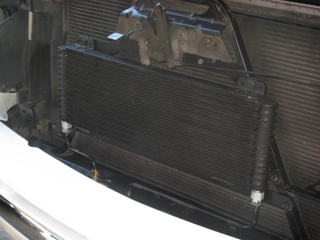

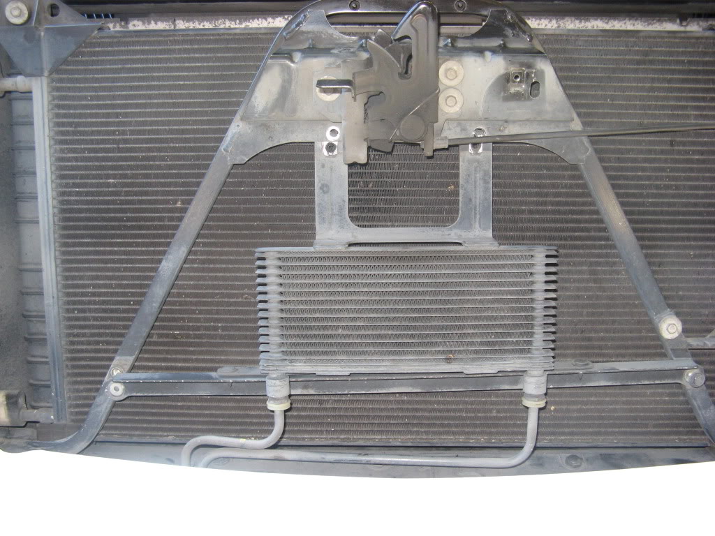

Here are 2 pictures of the 40K Install using the EAD Mounting Bracket Kit on my Truck, the Kit includes both Upper and Lower Mounting Brackets and Bolts....2 Inverted Flair Fittings and the Compression Fitting,
As you know The Passenger-Side uses the Compression Fitting.....on the Driver-side there is No mod needed to be done to it..........once the Compression fitting is installed on the Passenger-Side Trans. line....the 40k mounts right up with the Factory Trans. lines.....there's an (Plastic)E-Clip on the Underside that Holds the Factory Transmission-Lines in place, Remove that (Plastic)E-Clip it will Not Hurt Anything and Allows you to Slide the Driver-side-Transmission Line over some, to Mount it up to the 40k Cooler, after that the Rest of the Install is a Plug-n-Play.....
