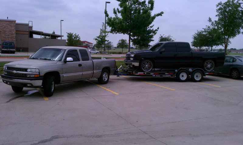

This past weekend I beat on my truck pretty damn hard towing this
With another 700ish in the bed and 3 people with all their **** in the cab.
All told I was probably pushing 12000 GCVW, I've got a built 60e with a normally 2600 converter but with all the weight and foot to the floor could get it up to 3000. We were stuck in construction traffic with mid 90 ambient temp the highest I could get my trans temp trying to get it hot was 190, not bad considering my baby cammed lq4 is putting out a decent amount of low end tq and stock temps run over 200. I can't stress enough how great a setup this cooler is. I've been running them since 05 and haven't used anything different since on anybody's truck I work on.
