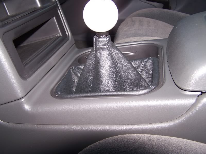

I figured out the shifter handle was custom, it was the cupholders and boot that was throwing me for a loop and that explains why I wasn't finding anything for it lol. Anyway I could get a how too from you on exactly how you were able to make it work?
I cut the bottom out and carfully shaped the divider notch at the front with a hand file.
I ordered a custom leather boot from redlinegoods with my dimensions to the handle per their custom order specs. If you want to cover the cup holder slots on the passenger side with the boot, have them leave 3-4" of extra material. I didn't and used a black antifreeze jug platic and glued it in (hind sight is 20/20).
I used 5/8" ish wide steel shipping banding to secure the boot. I hand bent and formed the banding around the inside of the hole, drilling 1/8" holes through banding and plastic to hold it in place with screws as I went. I had to cut "V's" in the banding in the corners to conform to the compound angles. dis-assemble and re-assemble with boot. Once all is the way you like it, remove one screw at a time and install a rivet.

I looked back and found this in post #474
I finally finished my shifter boot!
Ended up with plan 1 since it was more simple and I finally figured out how I was going to do it.
I used steel banding like used in shipping on palets.
-I bent the banding to the shape of the inside of the cup holder compartment.
-Using clamps held it in place as I worked it.
-I began drilling 1/8" holes and installing 1/8" sheet metal screws one at a time.
-After I get all the screws in I take it back apart and install the boot with the screws.
-Once all the srews are in I removed them one at a time and put in rivets since the screw head would be too thick and in the way for the cupholder assembly to snap back in.
Old Jan 6, 2011 | 11:50 AM
  #873
tiffo60's Avatar
Joined: Aug 2006
Posts: 1,183
From: Fort Worth
Thats the info I was looking for, thank you
