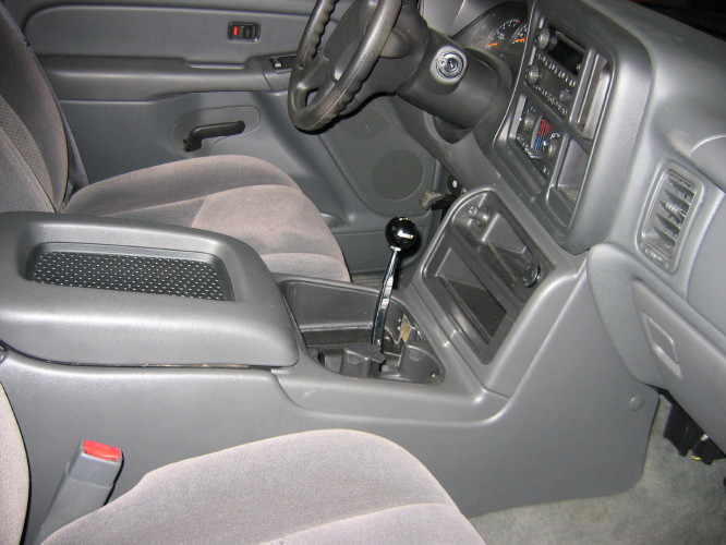

What year F body shifter boot is everyone using for their consoles ? Here is a picture of mine .
Maybe I didn't pose my question properly. what I am trying to ask , is what kind of boot is everone using in their consoles ? I have my console in but I don't know what boot to use.
Thanks Ron
