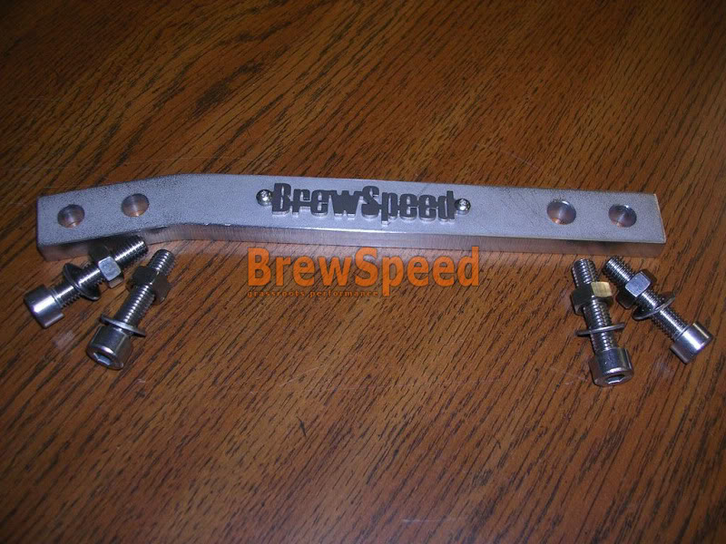

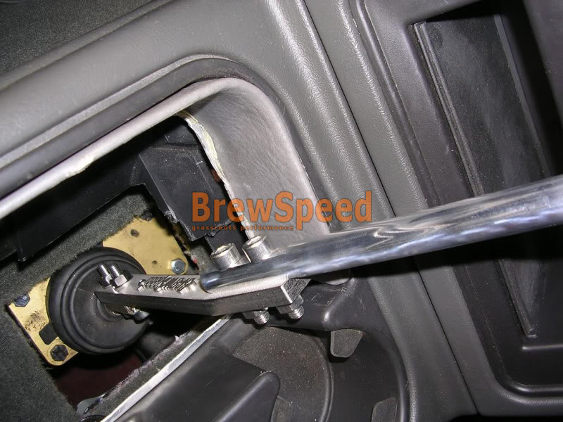

Look what I found on honda-tech.com, before you guys give me crap I googled "T56 silverado radix" so.. that's how I ended up on a Honda forum LOL
http://www.honda-tech.com/showthread.php?t=2568141
Truck was sold back in 2008
https://ls1tech.com/forums/vehicles-...10k-miles.html

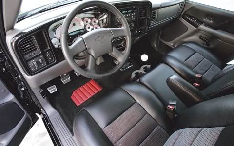

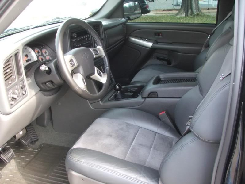

can you email me some photos? Here is my current interior and location of the stick. I dont want to cut another hole in the floor and buy new carpet that is not available.
