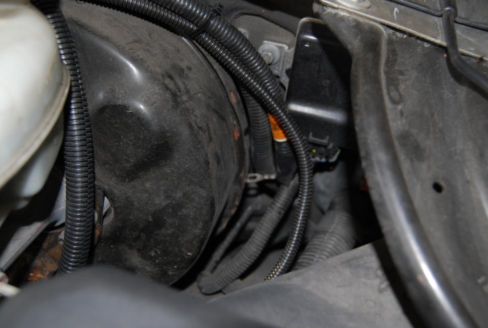

OK, while waiting for pics from the others i checked out my trucks underdash area and I DO have the spot to mount the pedal (much to my surprise... BUT, I do not see any the Mastercylinder with mount under the hood due to stuff in the way...??? Maybe I have to relocate the little black box looking thing next to the Brake Booster?

that black box is your TAC module . . gas pedal box
Well, It is going have to get moved whether it wants to or not... Actually i am looking at doing the Hydro Boost Brake swap so, between that and moving the TAC moduale I should be able to fit the Clutch pedal parts in place.

You are going to have to relocate that. Once it's moved, you'll see/feel a dimple in the firewall. That's the center point where you need to drill a hole for the master cylinder. Underneath the dash, that perforated circle needs to be removed, because that's where the master sits.
AHA!!! Thats what I was hoping someone would say... I still want to do the Hydro Brake Booster but, if I don't have to do it to install the Clutch/Master for new Transmission then thats all the better!
